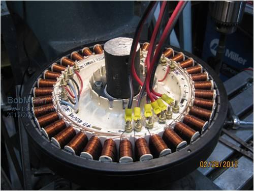

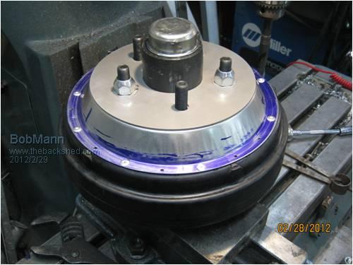

I just did some testing on the Low cost Smart Drive it went well. This one is using the 5 lug hub same axle and that stator is still stock just set up to swap out coil compensation. I do have a 4 lug hub setup but the cost saving is like only $ 17 and I have had some bearings fail over time on the small hub.
It has no cogging, light weight, works very good. Noiseless

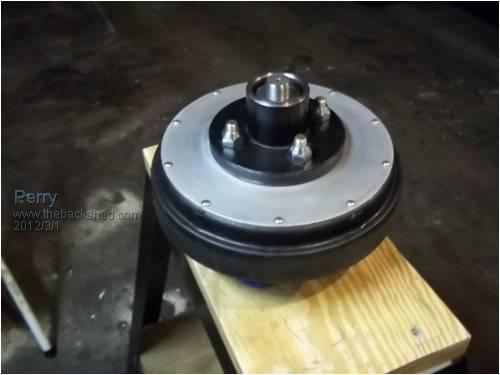

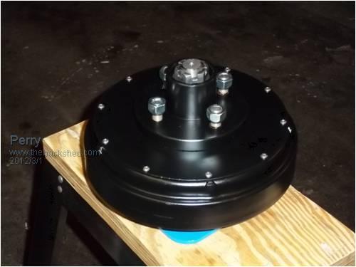

Wait a minute now Bob, that looks suspiciously like the Perry Smart Drive! Are you going to rename it? I'm just breaking your stones a little bit and joking. I think you are more in danger from your wife when she keeps finding her pie tins missing. Dropping the weight of the brake drum does help doesn't it.
I think your numbers don't look too bad at all and good luck with your project. Your attention span does seem much greater than mine. Glad to see you are making progress. I need to get me one of those controllers.
