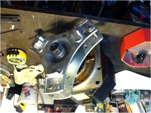

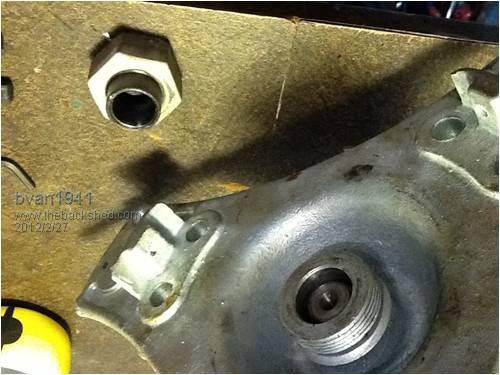

Gents, (Sorry for pixs being upside down ????)First pix posting-----
Found the "handle" to this --I think We'll see what happens.
What I'm trying to show is the Hub and Servo mating. The Hub is the Powermax hub assy and shows the nut(on the table) that screws into the end of the shaft. The Machinist welded the nut to a female cylinder with thread matching the servo shaft.
Intentions are to drill the edge of the nut and "safety wire" the nut when tight to the hub at some point.
