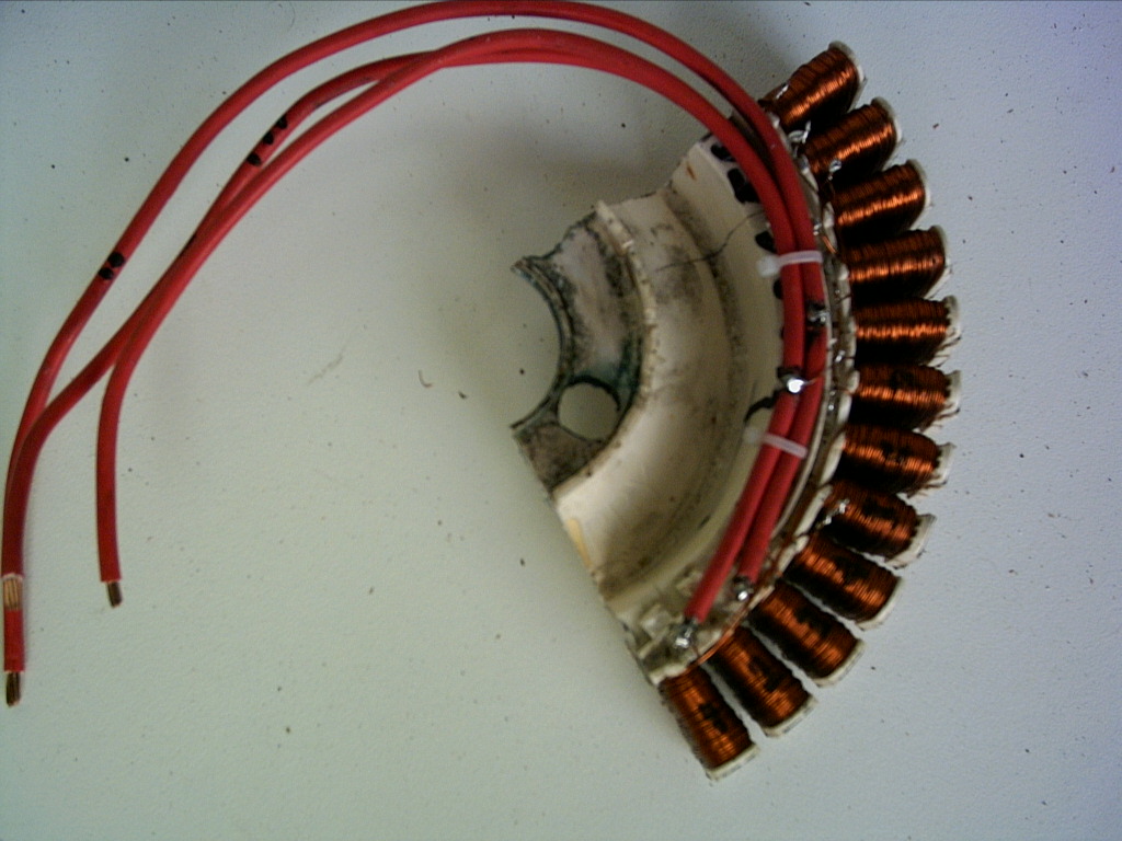

With a hacksaw I cut a wedge of 12 windings from 42 windings stator,and wired up as a 3phase star .Bench tested & rectified output was 13volts when spun hand.Heavy cogging ,will make a adaptor plate to support in the beariig holder .This may reduce the cogging. I will also try a 14 winding 7 phase cogless. Stay Tuned
