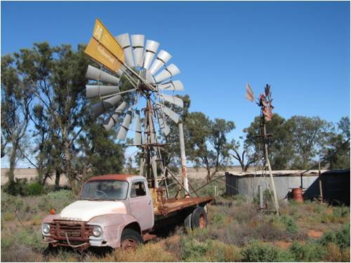

OK here's a pic, cant take the credit for this,its one of my dads projects. We were shifting it one windy day and the manual furl cable broke, I had her on two wheels for about 100 metres.

Not much skill involved from Me, the self furling mechanism cut in very quickly, but it took an eternity for the disc to slow down (no load on the pump).If it hadn't furled straight away, it would have pile driven itself into the ground in an instant.
They certainly have plenty of torque, I remember seeing an IDIOT chain a 20 footer, it snapped a 2 inch D-shackle like a carrot.
Haha "sweating bullets"
No, this was a pussy compared to Version one, it was moved with a crane and just squeezed under the 32,000 Volt power lines, except on a hot day when the lines sagged. That was a mandatory brown trousers moment
