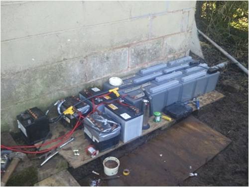

Hi
Working on a 12 v setup very concernd im going to put to higher voltage into the batteries im thinking if I use the bits out of an alternator may regulate it down until I get my charge controller built

the bits out of the alt; voltage regulator, don't work the right way.
the alt parts monitor the batt voltage allright, but what they do is put current into the exciter coil of the alt; depending on the voltage monitored, and turn the rotor magnet to various strengths so the alt output goes up and down.
You could use the regulator to turn a switch on and off useing a relay to turn the system to dump or charge circuit but I think a physical switch like this will chatter and arc, maybe a cap across the coil leads will help
