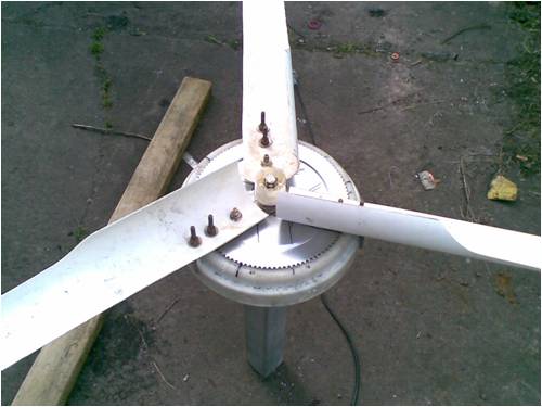

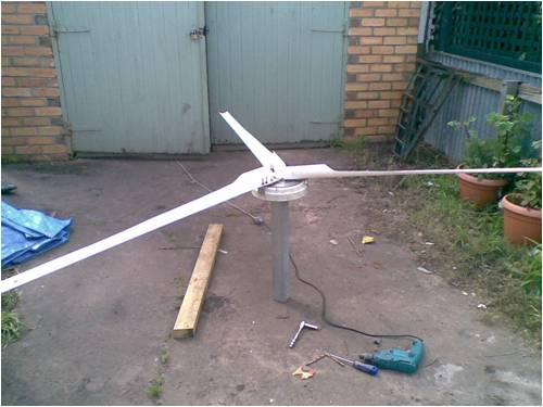

Hi guys thought it was time ti post some more pics will have my tower soon 35 foot self supporting I have to remove it but its free so a little work never hurt anyone

Looking good, I think you will need to plate the inside of the blades where the nuts of the bolts are or the blades will get ripped off the stator.
Many underestimate the power of the wind and the loadings applied to the mill.
Pete.

lol funny you should mention that we got up on the shed roof with it in light wind with a few gusts nearly got lifted off so its in the shed getting reinforcements now will post some pics when i get it finished
