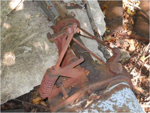

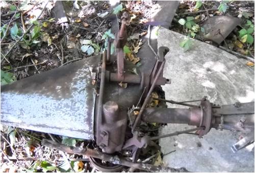

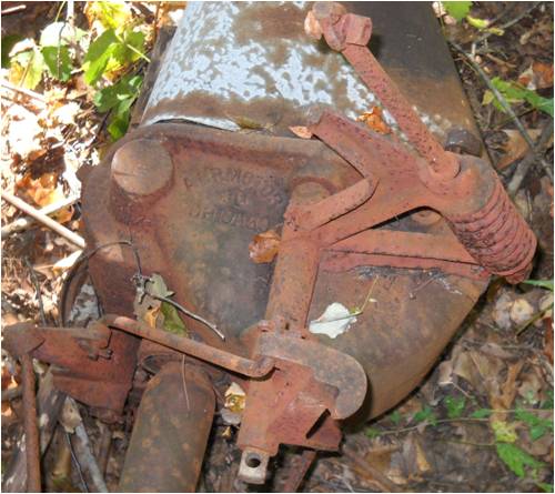

Here is 3 photos of Isaiah 1931 Airmotor motor windmill, may get some others tomorrow.

Looking at the top picture you see the tail mount and furling device on the right side.
On the left side you see a cast hub this is the back side of the blade shaft housing and at the bottom is the pivot shaft. if you look to the far lift and down towards the ground you can just see a bit of the break drum and band. The distance from the tail mount to rotor center is 5 1/2 inches. offset roughly 2.3/4 inches each way.
The bottom picture the small rods running down to the collar are part of the break actuator. the beakdrumand band can beseen a little more in the bottoom pic. The tail is up buy the house I had to take it off when I brought it home years ago. It was quite a load on a 1/2 ton pickup!!
I don't know about Downunder but The Airmotor was quite popular in the states. You still see some sitting around old farms and the Amish buy and rebuild them.
