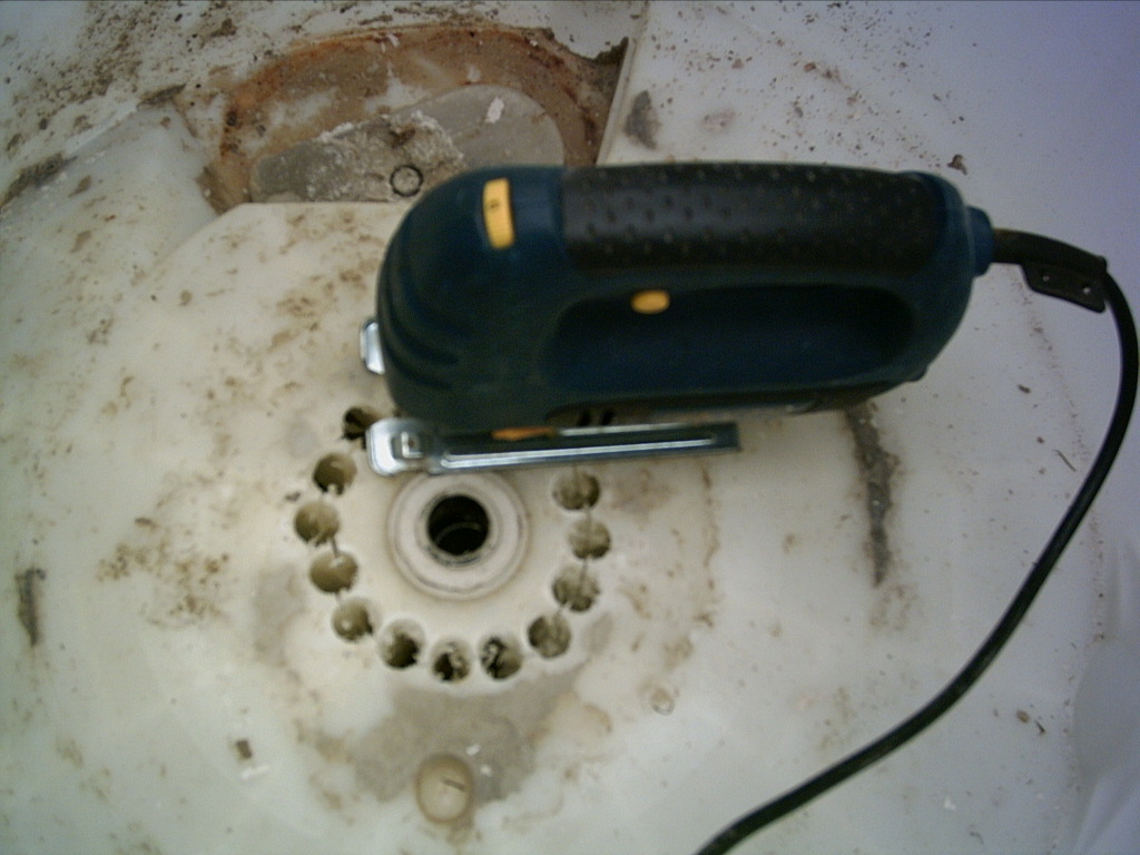

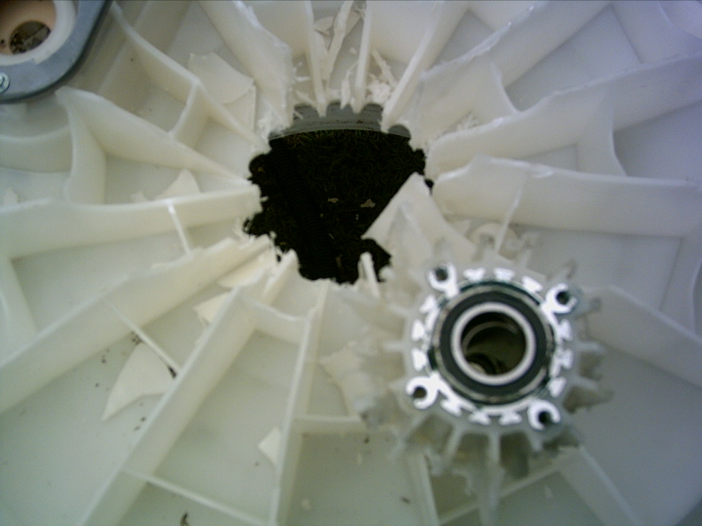

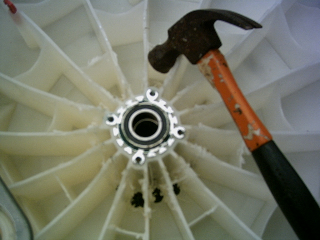

Hi this is the method I use to remove the plastic bearing holder from the base of the machine.
Use a large drill bit and drill out around the bearing holder. next from the inside& outside use a jigsaw and cut between the holes.
Next use a hammer to breakout the bearing holder from base. use safety glasses also.
holder should break free
AJ
