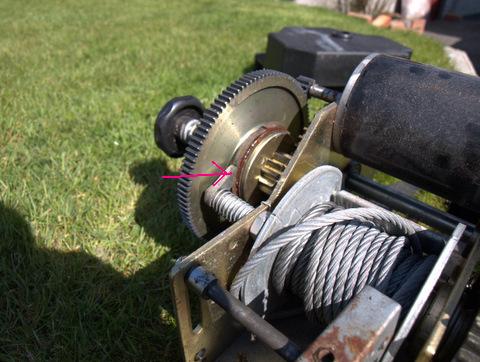

just a little bit to add on electric winches...well as least mine anyway...i can only comment on this model...
i used to use it on the mill and it worked fine ...but one day i noticed the characteristic clicking sound it made had stopped ......this turned out to a failed spring on the ratchet lock ...this allowed the mast to creep (back feed) if the motor was off...a bit unnerving to watch
i did reform the broken spring end....but only used it once after that.....
if the winch was used on a flat pull nothing unnecessary bad might happen ....hoisting something would be a different situation ..i think Edited by niall1 2010-04-18

nial- i'll bet that didn't feel very good watching your tower move down instead of up. atleast your winch has the audible click to let you know the brake is working.
my truck winch is the planetary gear type. it absolutely lock up under any load, unless you switch a lever to free spool, but this lever is pretty hard to turn, so i doubt you could ever accidentally switch it. initially i figured i'd use this winch to raise/lower my tower, but it's kinda a pain to use and really beats up the battery in my truck.
