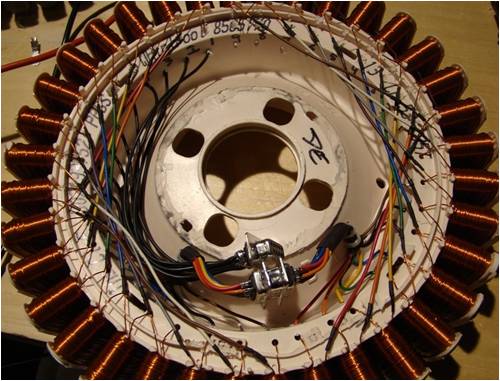

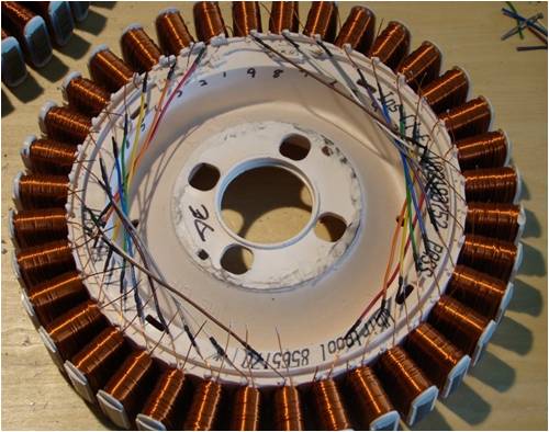

Howdy Ya'll,

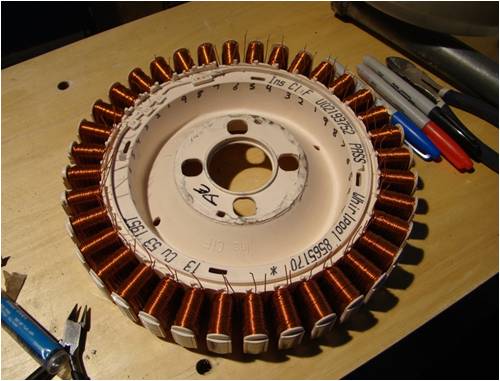

So now that you all have done the cog-less, 7 phase conversions to your F&P motors, ie... combining the rotor (48 pole magnet ring) from a 36 pole stator with the 42 pole stator. and yes, it works wonderfully, what to do with the left over parts, ie... the rotor (56 pole magnet ring) from the 42 pole stator and the 36 pole stator...well, here is an idea. I did the math and the computing and came up with an even less cogging, 9 phase conversion. I also made it so it is possible to go from being a 1x4c to 2x2c. Just like you would do for the 7 phase conversion, divide the stator (36 pole) up into 4 sets of 9 poles.

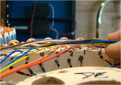

unfortunately, unwinding each coil one turn will not reach to the 10th pole like you would do with the 7 phase conversion,(except you stretch it to the 8th pole for that), so with that being said, go ahead and rewire the stator, but dont go all the way around, only wire the first 9 poles to the second 9 poles, then rewire the 3rd set to the 4th set

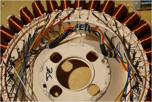

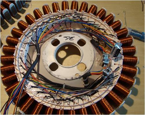

now that you have 2 sets of 2 pole sets in 9 phases, between the 2 sets, wire and solder in a 9pin connector, i used a 9 pin dip connector.
now, on one half, bring all the commons together(the black wires on the left side in the pic) and solder them to another 9 pin with long enough leads to reach up and connect to the other half's 9 pin connector. be sure to use the same pin set (male or female) as the other end of that half of the stator. also be sure to ground them all together as this becomes your master common for all the coils in the stator, be it configured for 2x2c or for 1x4c
this is going to allow you to switch the motor from 2x2c to 1x4c.
now you get to finish up by connecting the last set to 2 9 pin connectors, one to connect to the other half of the stator and the other as your power output.
if you notice in the picture, the last set of wires go through the plastic housing, as it does, the wires coming from the last set of coils is soldered to them as one end runs up to a 9 pin connector to be connected to the other half of the stator, the other end is your power out from the now generator stator
now this conversion process is a bit complicated and even i have to sometimes stop and analyze the wiring and connectors to ensure i am connecting them correctly.
To go from 2x2c to 1x4c, the "common" plug should already be plugged into the beginning side of the second half of the stator (or set 3 in) and the other 2 connectors SHOULD be connected together. Disconnect both sets of connectors and connect ONLY the "set 2 out" and the "set 3 in" and leave the other 2 connectors disconnected.
have fun with this if you decide to do it, i now have and additional generator. it will be interesting to see what kind of replies i get from you all.
