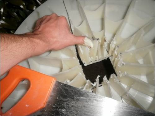

Guys I noticed on the homepage dismantling of the machine doesnt cover removing the bearing block.
the NZ boys tell me the chainsaw is not a good idea and a hacksaw doesnt have the throat to deal with whats left if an angle grinder is used but a plain wood saw cut through it like butter.
Obviously fillm is using this bearing block and now its proven and cheap may want to add this as like others, I threw it away considering it was too hard and I wouldnt need it.
All up 5 mins.... can even be done on the nature strip as previous owner looks on in horror!
still less obtrusive than a chainsaw being used to carve up their old machine.
band aid on the thumb is unrelated!

The handsaw method works a treat. When the plastic bearing block is cut out, you can use an electric planer to clean it up to a nice smooth and straight finish on each side. The planer seems to cut the plastic easier than wood.
