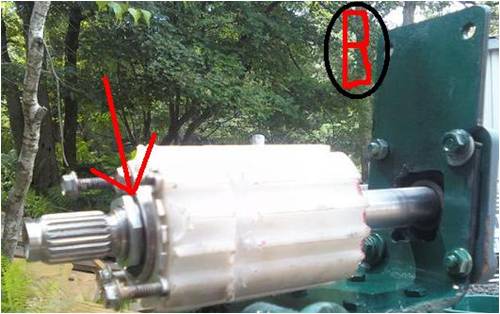

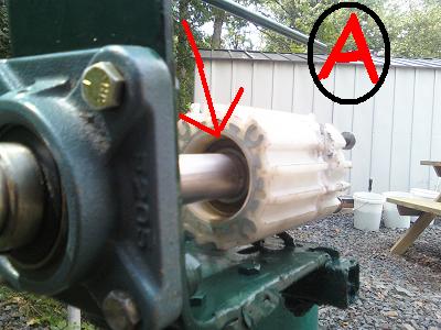

Thanks for the answers.. I eyeballed it again and am a little confused. I took some close-ups so I can make sure I get this right.. Sorry for my constant questioning and lack of knowledge.
GWatPE, As I understand, you are suggesting shimming between the shaft blocker ridge (Picture A) and the bearing? So I will have to find washers that will fit around the shaft but fit inside the plastic housing ring? If I did this, I would imaging it would cause even more friction on the bearing. Perhaps I am mis-understanding.
Greenbelt- I'm looking at the pic and trying to correlate to my setup. I don't even want to try dissembling the bearing from the housing. But I see where you are coming from. The bearings on the white plastic holder are spaced out just enough to snug it up too much. So I suppose the answer is to lightly tap the outer bearing in a fraction of an inch?
Can this bearing be tapped in? or is there an inner structure (inside the plastic) holding the bearings in place?

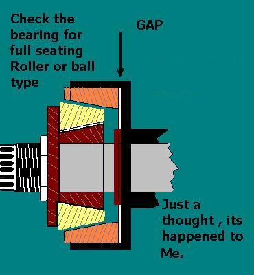

I'm not familiar with the hub you are using, bearing type,or method of securing it in place. Some use snap rings to locate the bearing, usually ball type, the common way is to machine a diameter in the hub that is a close fit to the bearing size, When the proper depth has been reached to match the width of the Bearing. the Machining stops, This is where the Bearing stops when it is pressed in, Or tapped in. The Gap in my Pic. is this
place. If a shim is needed, you will have to remove the
bearing from the shaft and install it first.
Your shim should only contact the inside diameter portion of the bearing.

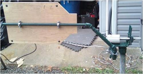

Today I started working on completing the furling and the tail piece.

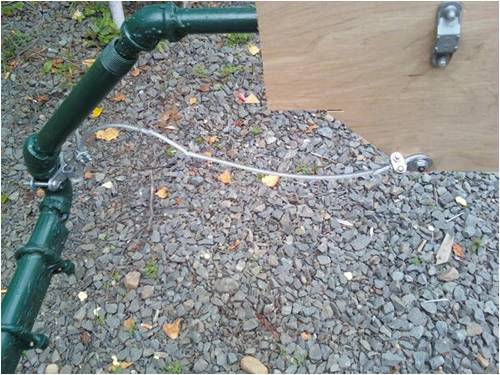

I attached a guy wire cable onto cold water clamps to act as the "furling stopper" (for lack of a better word). It also discourages the tail from sliding too far out of the pivot pipe.
Here is a view of the tail in full furled position. If it goes past this point, the whole contraption will turn on the ya bearing
I will paint the tail probably white.
Hope this furling will do the trick.

OK, so I spoke to Randy (supplier of the F&P and the bearing) and we discussed the binding issue with the end nut. Since the bearings can't be moved or adjusted without machining, I must either use some permatex on the threads and not tighten it all the way, or my idea is to dremel a tad off the shaft blocking ridge. I just have to find a way to give the bearings a little more room.

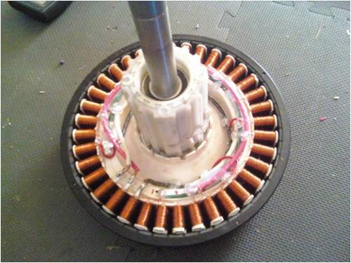

So, last night I worked on the Stator. I have a new 36 Pole F&P, so I wired it in the star configuration. But I followed Randy's guide and used a ground wire across all common tie-togethers.
I used 8 gauge wire and two soldering irons.came out a little sloppy (like everything I do obviously), but every connection was made strong and I hot-glued it all in place.
When I hand-spin it, I see AC voltage coming out. Hard to get numbers hand spinning, but I say upto 18 Volts coming out between poles.
The outer rings of the bearings are held by friction fit on the aluminium housing embedded inside the plastic.
The shaft has a slightly bigger diameter than the bearing inner between the bearings, preventing them from moving too close together.
I usually use the shaft to gently tap the bearings out. Remove the nut completely and use a plastic or copper hammer to avoid bruising the shaft end. The far bearing will come out first, you then have to re insert the shaft and tap the opposite bearing out.
