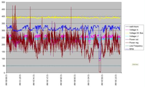

I have some data from a windmill at a good wind location. This windmill, 2.5kW rating, Skystream3.7 has produced 20kWhr in a 12 hour period.
This is graphed data for a 1hour period. the mill produced up to 4.5kW at times. This is connected to a 48V RE battery bank, so approx 90A was put back at times to the battery [650Ah] through the Outback inverter/charger.
This is not a homegrown system but I offer it as an example.
With grid connection and a good wind site, this could subsidise holidays pretty well.
Gordon.
PS edit: the brown trace is the power produced.

oztules

Posted: 11:53pm 11 Apr 2009
Yikes!!!!
.......oztules
Posted: 03:37am 12 Apr 2009
  oztules said   Yikes!!!!
You can imagine the difficulties with diversion loading this beast. The 4.5kW peaks create some problems with the physical sizing of the heater. A significant part of a wall is required for the radiator bank. I have been told that the room gets quite warm in a storm.
I have had a bit to do with this installation. I am looking at a revised 240V, AC coupled proportional loading system, modelled on the setup I use on my own battery bank, that gives programmed boost, equalization, absorbtion and float voltage settings. This will be an ideal use for some 600V 20A mosfets, that will be arriving shortly. The battery maintenance aspect is difficult to incorporate in AC coupled systems at these power levels.
Gordon.

Gordon, any chance you could email me the data used to produce this graph? Over a week period if possible?
That would be much appreciated!
matt at mattvenn dot net
Posted: 11:30pm 12 Apr 2009
Hi matt,
Gee, only a week. I can't see how someone else's data really would be of any use, considering your application. A weeks data from this mill would be approx 10MB file as raw data, and of no use without the application that knows how to display it in a graph. I had to do quite a bit of data manipulating [merging of files and date/time stamp calculating] to get this graph from raw data. the data is recorded at about 3sec intervals for 30 parameters, and the limits of Excel are pretty soon reached.
I offered the graph as an example, for interest only.
I guess this is a no.
Gordon.

Posted: 10:17pm 16 Apr 2009
Gordon,
I was asking because I couldn't really see the graph because it seems low resolution on my screen.
It might not be entirely relevant to this project... but I'm interested in other projects and you seem to have a lot of data!
Which reminds me, have any of you checked out this crazy website?! http://bwired.nl/ Now THAT is a lot of data!
Posted: 11:06pm 16 Apr 2009
The graph is just a screen capture .jpg. I do have a lot of data, relevant to wind sites I have access to. I offer advice to other real people, and not just those in cyberspace. I have limited internet bandwidth so I refuse to support sites like U-tube etc with MB downloads needed. Maybe with a fibreoptic connection, MB/s downloads, but this is a way off for me yet.
