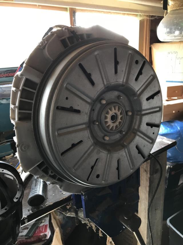

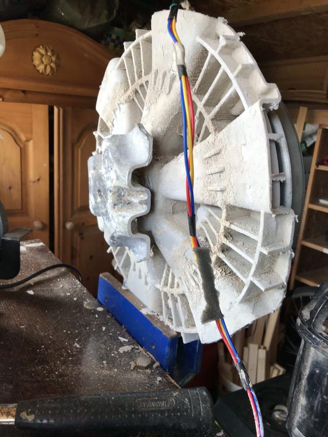

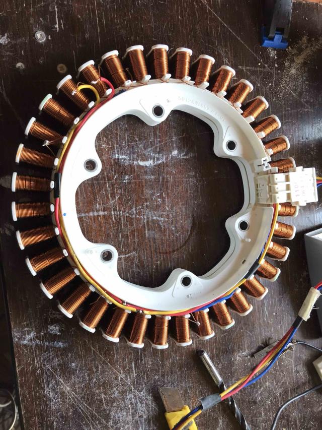

I have taken a Fisher Paykel motor out of a washing machine. It is a 36 pole version. I have rewired it to 3 x 4C as per the great diagrams on this site. I have cut back the parts of the washing machine housing and am still using the original hub from the washing machine.
I have wired it up to a 3 phase rectifier and then is wired to a light bulb. Hand turning produces nothing. I attached it to an ammeter which produced a large amount of resistance in terms of finding it hard to hand turn it.
I have attached a couple of photos to show you how far I've got. Any advice is greatly appreciated.
Seb the novice.
Posted: 10:21pm 01 Apr 2019
Finding it hard to turn with the amp meter connected is normal, a good sign. Was it also difficult to turn with the light bulb? It should be, but not as hard as the amp meter.
Can you test the output volts while turning by hand?
Also thats not a F&P, its a LG. Works the same.

some late info.   if you want a good pma, just  BUY ONE.  on ebay/amazon.   look for permanent magnet alternator, and KNOW  what specs you want.     re-purposing an f&p motor is LESS simple, than one might think.   the motors are  MULTI-pole, 3-phase, bldc, outrunners.     in a 36 pole stator, there are  TWELVE coils per phase.
in a pma, there should ONLY be  three coils per phase.    changing the config of a stator, DOES NOT CHANGE THE CONFIG of the stock rotor.   some people have come to believe that it is a good idea to Interconnect  ADJACENT coils.   IT  IS   NOT.
