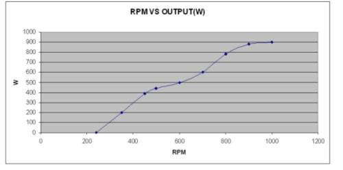

Here's a graph of what the output might look like with Stator1 setup as 24V 80SP Star and Stator2 set up as 24V 80SP Delta
My Thanks to Michael at EcoInnovation for kindly letting me use his data to create the above graph

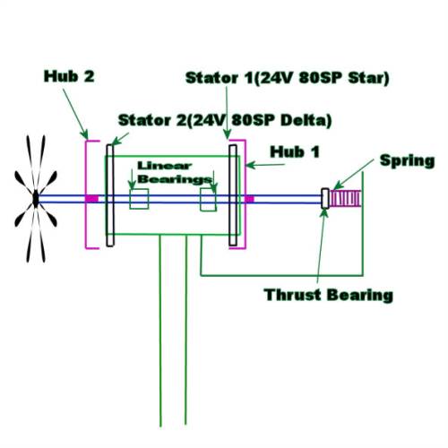

For those who hate working things out from descriptions, here's a diagram.
Actually, when I did the drawing, I realised the hub bottoms would be facing each other, not their tops as I described earlier.

Though I see it's output as to be compared against a single rotor design rather than a twin.
It's min and max is still the output of one rotor though when set up right the combined power outputs will follow the wind power rather than it's velocity curve I feel. Great!
Would not the combined outputs of 2 individual fixed rotor wind gens, if wired the same, be more though?

I agree with Gill in that you will get more output if you just leave the two stators connected. PowerOne makes an inverter that I have an I on that allows you to select the amount of wattage you want to draw for a specific voltage or rpm. This way you can put a low load at low rpms and increase the load as the rotor spins faster. I think that when you start getting into more complicated mechanical designs the risk of failure increases.

Dazz, did I miss it? I mean the obvious plus point that your scheme has the cogging of only one F@P at start up? I think your scheme has a lot of potential if you have a lot of light wind days.
I do wonder though if you would be able to get a smooth transition between the two. Wont the low speed rotor tend to 'hold on' to its position until finally lets go and the high speed rotor get to grab it's stator and pull it in?Edited by KiwiJohn 2008-05-28

The transition I'm not really sure about. you could well be right there. Annother associated issue is that the force of the wind must be able to push the first hub off it's stator. Is this force big enough?
I do know from my SMFIS work that when lowering the hub onto the stator there is no force pulling it in and then suddenly a lot of force pulling in, which seems to stay roughly the same for the rest of the lowering.
I'm hoping to find a point where the forces on the hubs are roughly even but opposite, but who knows. Maybe the wind force is strong enough that it doesn't matter. If there is a quick transition at the end as you suggest then perhaps a shock absorber of some kind will be needed too.

Obviously with such low values allowance must be made for considerable error
Daryl
Posted: 12:13am 29 May 2008
Hi dazz,
the computer lab must be providing wrong numbers as well. Increasing the wind velocity from 10m/s to 22m/s increases the power by a factor of 10.5, not 8.8. Gordon.
dazz
Joined: 15/04/2008
Location:
Posts: 78
Posted: 04:45am 29 May 2008
Hmmpff Perfectionist!
grolly
Joined: 19/05/2007
Posts: 62
Posted: 10:55am 30 May 2008
dazz,
How about a set of weighted balls to move the second hub over the stator, so you have a 2 stator unit at the mean wind range, and another set of balls to pull the first hub off the stator at high wind speeds.
Also thought that moveing the hubs would be easier and cheaper, so you could secure the prop and shaft, owing to the high latteral forces that you would have when it furls at 1000 rpm ( mine keeps chewing out the rear bearing housing)

dazz
Joined: 15/04/2008
Location:
Posts: 78
Posted: 11:41am 31 May 2008
Hi grolly,
I imagine the balls system would have trouble coping with yaw, especially during furling
