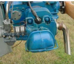

Holy Cow you guys. You just got this ol mans brain shifted to something I didn't know existed. That is so intriguing. TEGS WOW!!! I love to think out of the normal box and find ideas to accomplish a same result. There are so many ways to produce electric energy and I want to find an idea that will produce enough to replenish what the engine coil uses when running. You guys are so knowledgeable with this stuff.
Here is a pic of the engine. The exhaust pipe idea would work I think.

Thermoelectric cells are certainly interesting things to play with, and I suggest you just start out experimenting with just one. Excess temperature will kill them, and that might occur after landing and you shut down the engine. The cooling air stops, but the heat from the exhaust continues for quite some time.
Might be best to mount the TEG on a heatsink and duct the heat to the TEG, rather than mount it on the exhaust and duct cooling air to the TEG. A couple of thermocouples will tell you what is going on temperature wise, and you can experiment with different layouts.
Something pretty simple should work once you figure out a way to keep both the hot and cold temperatures within reasonable limits.
There are two different types of thermoelectric cells. Peltier cells are used for cooling purposes only and are very low cost. In theory they can also be used as TEGs, but when I tried that myself they produced very little output and always failed fairly quickly.
I think it has to do with the materials and construction. For cooling purposes the temperatures are never very high on either side, so crappy low cost materials work fine for thermoelectric cooling. A TEG on the other hand has to run at a much higher average temperature, and the devices designed for cooling just lay down and die.
Beware of Cheap Chinese Peltier cooling devices, I think you will be very disappointed.
Proper TEGS will probably cost more and be a lot less common, I really do not know.
Never really looked into that side of it. I have a fair bit of personal experience using Peltier cells for cooling applications, but have never messed with the proper TEGS for power generation.
You could probably start out with just one TEG and do some initial testing on the kitchen stove.

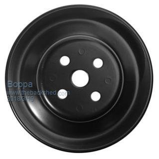

  yahoo2 said   I guess it all depends what your skills are, I could build the pulley, bracket and shaft adapter from scratch in a day, maybe two for a serpentine belt and springloaded idler.
With electronics every time I make a mistake it is another two week wait for bits to come from china. I find if I have a project with more than 10 unresolved issues the chances of it making it to completion is pretty slim.
Personally Id look at a pulley behind the prop(ie take prop off, fit pulley and refit prop), something like an old ford 250ci steel pressed single belt pulley could be adapted, and fit that small 20a alternator. Very little work and well capable of supplying the coil power
eta no need for a serpentine belt and spring loaded tensioner, just a simple vbelt and old fashioned slipping alternator bracket aka old holden/ford would be more than adequate, much less weight and much less fabbing required
woops was a little bigger than I thought, resizedEdited by Boppa 2018-03-20
