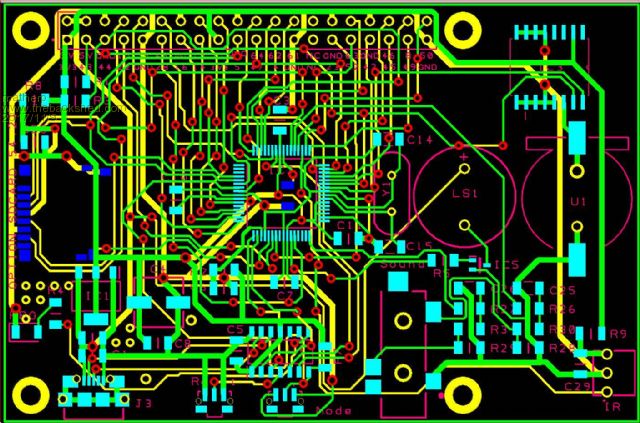

By popular demand (of one person ), here is a design for a new PCB for the 64-pin MM+. Copper pour areas are removed for clarity in the picture.
The PCB is the same size as a Pi 3 and will fit in a standard Pi case with all connectors and headers correctly placed as per the Pi.
It includes:
40-pin Pi HAT header with SPI, I2C, COM, PWM ports placed as per the Pi
DS3231 RTC and battery backup
Audio output as per MM+ manual
IR receiver
microSDcard
MicroUSB power and I/F connector
PIC16F1455 console USB I/F and PIC32 programmer
Buzzer
RESET and MODE switches
If this is of any interest, please advise. I'll post gerbers once the first version is tested and any bugs ironed out.
As usual PCBs, in various stages of completion, may be available from WW if he has his arm twisted

Posted: 11:27pm 09 Nov 2017
Very surprised to see no-one jumping up and down about this - because it sounds very good to me. If WW makes them available - I'll have one.
(so that's two!)

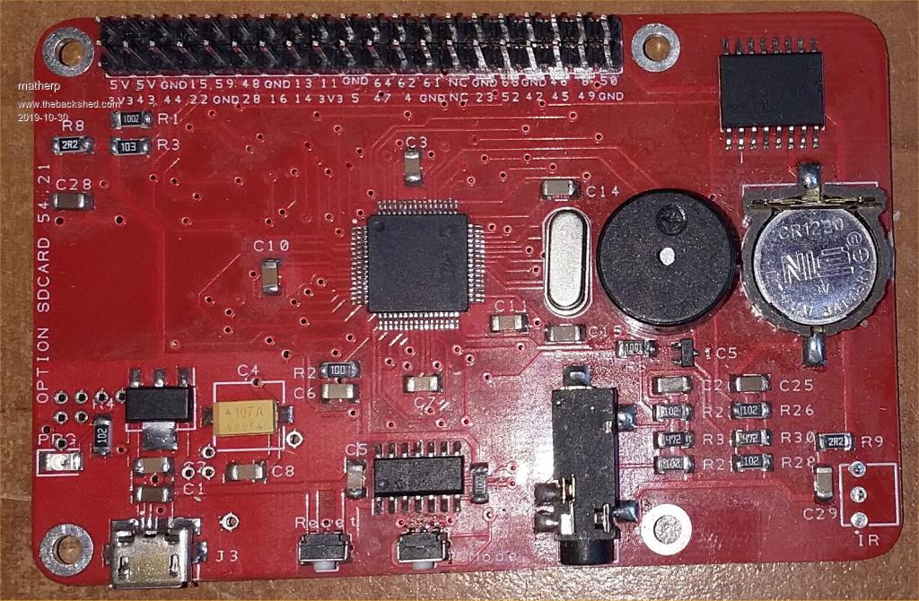

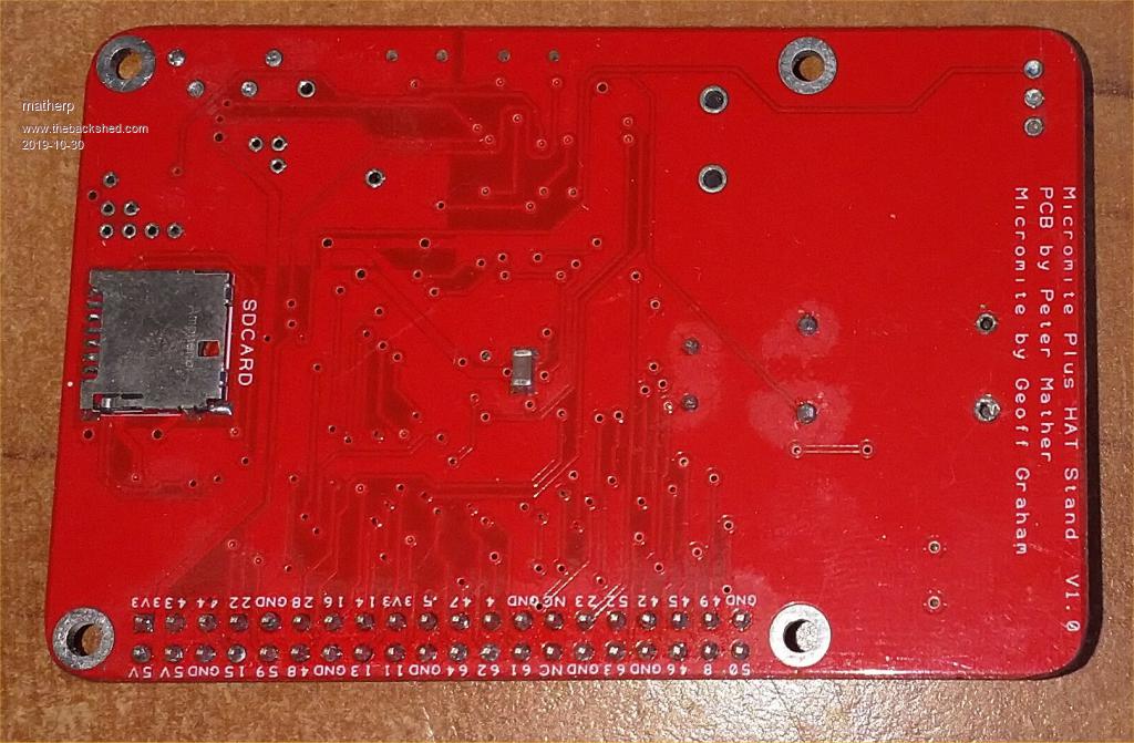

Posted: 08:03am 30 Oct 2019
MX64HATSchematic.pdf
HAT64MX.zip
Posts: 9329
Posted: 03:01pm 30 Oct 2019
Nice! I like the way you got the GPIO pins to work out so well. I've just been comparing them with the RPi.
My soldering iron is getting itchy. I might have to get some boards made. :)
Thanks, Peter. :)
