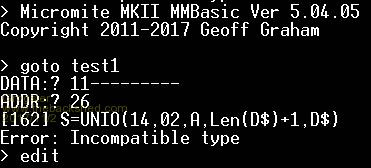

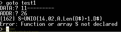

Result with S declared:
Result with S NOT declared:
Both ways generate an error, so what gives?

QUESTION: In PDF for the UNIO driver, the syntax is given as 'status=' blah, blah, blah. Is this 'status' variable name mandatory? IE: Does the command HAVE to use 'status=' in the command, or can you use any dummy variable name - which I thought you could?
EDIT: It appears that it IS mandatory. If I change my 'S' to 'status', everything works fine. Perhaps this needs noting in the PDF, if it is in fact the case... Edited by Grogster 2017-11-03

Yes. If I DIM status AS INTEGER, then that is when I get the error about 'Incompatible type'.
IE: If you DIM status, I get an 'Incompatible type' error. If I DON'T DIM status, I get an 'status not declared' error, so one error fights the other, and you can't win no matter what you do.

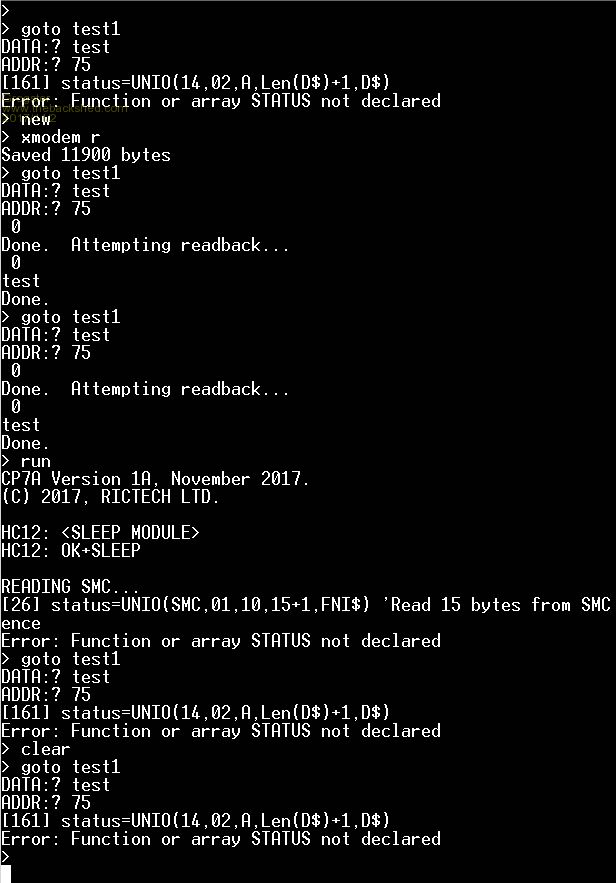

OK, this is getting interesting. Original code works. New code does not, but the only change was my slowing the CPU to 30MHz and clearing the variable table(as I was getting errors from that), which is still 10MHz above what the PDF states is the minimum, so I figured I would be just fine at 30.....

EDIT: Makes no difference at all. I can change the speed to 48MHz, or leave it at 30MHz, and the test1 routine now works just fine - before it would not - EXACT SAME CODE.
WTF?!
The problem seemed to be cleared by NEW then XMODEM R a new copy of EXACTLY THE CODE THAT WAS NOT WORKING ABOVE. This is REALLY weird, and makes no sense - at all....
EDIT: Nope. As a test, I issued NEW, then XMODEM R the exact same code, now we are back to the same exact error as above. I really don't get this at all.... *scratching head*Edited by Grogster 2017-11-03

OK, here is a bit more information. The test1 routine will run OK at the command prompt from the point of XMODEM, but as soon as you RUN the code, the code falls over at the first UNIO read command, then if you try to run test1 at the command prompt again, it falls over forever from that point on.
If you study the flow of this command-line test, you can see that from the first XMODEM transfer, it works fine. As soon as you RUN the code, it falls over. From that point, it won't even run test1 at the command prompt, whereas before RUN, it DID.
....I'm lost, sorry......

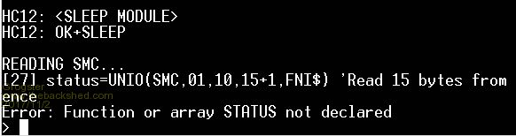

No, it doesn't. If you re-read my earlier posts, the problem I am having is that if I DO DIM status as integer, I get the 'Incompatible type' error.
If I don't DIM status as integer, I get the 'Status not declared' error.
One error fights the other, and you cannot win.

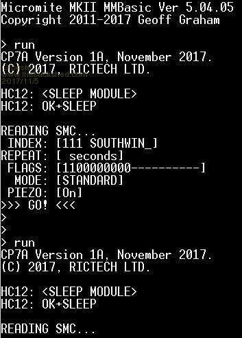

Yes, the code works fine - until it doesn't. When it is running OK, everything is fine, but then I get those errors, which would seem to center around the 'Incompatible type' error. I only hope Geoff can replicate the error at his end.

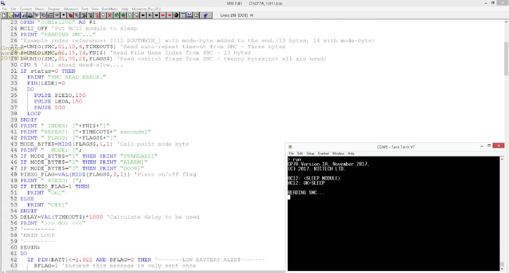

Here is a COMPLETE CODE listing as I have it now. I don't see how anything I am doing outside of the UNIO could be causing this, but just in case I had better post the whole code. This will also allow anyone else who wants to, to experiment and see if they get the same errors. This is NOT final yet, but this is what I have and am working on as of now:
Print "CP7A Version 1A, November 2017."

Probably not much to do with your issue, but I notice these three reads appear to trample on each other.
Starting at 7 and reading 3+1 takes it up to 10 (7,8,9,10),so next starting point would be 11 (not 10) for the next 16 bytes you read.The 15+1 read also takes you past the current start point for 10+1 read.
Print "READING SMC..."
status=UNIO(SMC,01,10,15+1,FNI$) 'Read 15 bytes from SMC - Unit index reference
status=UNIO(SMC,01,7,3+1,TIMEOUT$) 'Read auto-repeat timeout from SMC - Three bytes
status=UNIO(SMC,01,26,10+1,FLAGS$) 'Read control flags from SMC - ten bytes(not all are used)
CPU 5 'All ahead dead-slow....
status=UNIO(SMC,01,11,15+1,FNI$) 'Read 15 bytes from SMC - Unit index reference
status=UNIO(SMC,01,28,10+1,FLAGS$) 'Read control flags from SMC - ten bytes(not all are used)
Gerry

Hi Grogs,
I think I have found whats happening here, good news is pin 14 is OK.
I think the previous mentioned overlapping of your data in the eeprom made it look like it won't read. Correcting the offsets like below and it seems to work nicely.
Print "Writing SMC..."
status=UNIO(SMC,02,11,15+1,"123456789") 'Read 15 bytes from SMC - Unit index reference
status=UNIO(SMC,02,7,3+1,"999") 'Read auto-repeat timeout from SMC - Three bytes
status=UNIO(SMC,02,28,10+1,"YYYYYNNNNN") 'Read control flags from SMC - ten bytes(not all are used)
The confusion comes when you try to debug with the test1 routine.

Posts: 10110
Posted: 04:49pm 03 Nov 2017
Interesting. I will try that and let you know.
I did not figure that there was any problem piling up multiple calls to UNIO, as the Cfunction would only do one at a time, and so therefore, would not return until it had a result from the first one, BEFORE it tried to do the next one, but perhaps that is wrong interpretation on my part?
I also did not think there would be any problem with jumping around in the memory, as you specify the start address as part of the command, so who cares if you read ahead then jump back and read before?
Not neat I grant you, but I did not think there would be a problem with doing it that way.
I tried putting test1 into a sub with local variables, but was still getting the error, so put it back.
Your example should not change anything. The PDF for the UNIO says that that extra byte is just used by MMBASIC to keep track of the length of the string, but I fully expected that to mean that this was only for MMBASIC's purposes hopping in and out of the Cfunction, and that this extra byte is NOT written in ANY WAY to the UNIO memory itself at all.
IE: Write 10 bytes status=UNIO(14,02,10,10+1,"1234567890") will write TEN bytes and NOT eleven bytes, as you are only writing 10 bytes, and the extra byte is used by MMBASIC(not the UNIO) to keep track of the length of the string.
Do I have that totally wrong? Geoff?Edited by Grogster 2017-11-05
