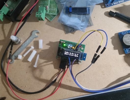

I am using the Mite to do 4-20mA to pulse and this
very tiny display is just right to show the 4-20mA
input and the divider and current pulse rate.

Thanks I wasn't looking as I saw that they hooked right up to
mick's backpack and started playing.
