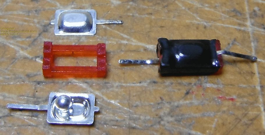

Here is a photo of the guts of a sensor I cut open:
You can see that when the unit is tilted, the ball rolls to one end or the other, and forms a circuit with the top and bottom cups. Extremely simple, and effective - once I disable the PULLUP option.....

Good idea, will have a play. I am sure the ball-switch is the issue, but not entirely sure WHY. I suspect that redrok is correct, and that it is a very thin oxide layer.
I suspect that is probably why my multimeter says they are a good short circuit when tipped, as the multimeter on low-ohms probably passes 5mA or so via the probes for the test, whereas the MM input will not - it will be micro-amps if anything.
Alistair mentions something similar at the top of this page, but when I examined a switch I cut open under the microscope, the ball and cups look very clean. But that does not necessarily prove anything if an oily layer was there, you probably could not see it under the scope anyway!
