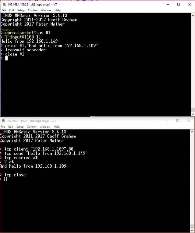

Please find attached version 5.4.13.
2017-10-22_104321_mmbasicstretch.zip
2017-10-22_104333_mmbasicjessie.zip
2017-10-22_105729_Pi-cromite_Manual.pdf
Changes are:
1. fixed bug in LONGSTRING TRIM
2. fixed bug in SYSTEM command to avoid last line appearing twice
3. changed parsing so that subroutines and functions can be executed from the command line
4. removed ability to run a disk program without using the RUN command
5. implemented TCPIP client capability
6. implemented TRANSMIT NOHEADER for TCPIP socket functionality

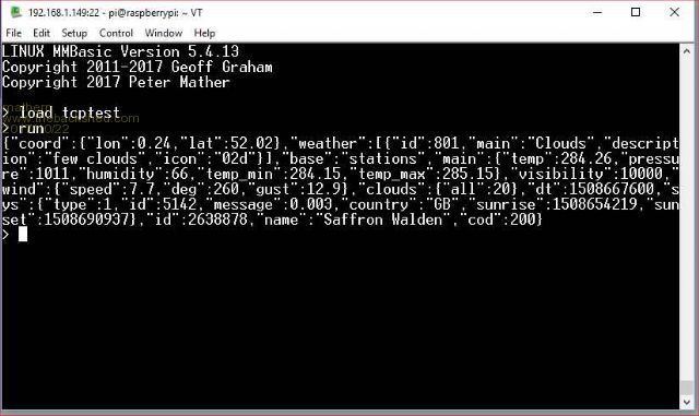

The TCP functionality is shown below using the existing OPEN "socket" capability together with the new TCP client. Also below is an example of using the TCP client capability to interrogate api.openweather.org
Option explicit
Option default none
Dim a$,b$,c$
Dim integer i,j,rlen
Dim m%(4000)
Dim MYID$="enter city code here"
Dim APIKEY$="enter your APIKEY here"
' get the IP address of openweathermap and open a client connection to it
a$=GetIP$("api.openweathermap.org")
TCP client a$,80
' construct the request for a weather report and send it
b$= "GET /data/2.5/weather?id="+MYID$+"&APPID="+APIKEY$
b$=b$+" HTTP/1.0"+Chr$(13)+Chr$(10)+Chr$(13)+Chr$(10)
TCP send b$
'set up a longstring variable and read the return message into it
LongString clear m%()
TCP receive c$
If c$<>"" Then LongString append m%(),c$
Loop While c$<>""
' trim off the HTTP header
LongString trim m%(),LInStr(m%(),"{")-1
rlen=LLen(m%())
' process the message, in this case just print it out
i=1
Do While rlen>0
If rlen>240 Then
j=240
Else
j=rlen
EndIf
rlen=rlen-j
Print LGetStr$(m%(),i,j);
i=i+j
Loop
Print ""
TCP close

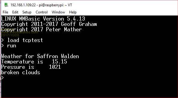

Codenquilts
Posted: 06:39am 28 Oct 2017
  Quote   I was unable to receive any data using this version and the browser reported "No Data" when I closed the running (web server) program
Ooops Left in a diagnostic change - sorry.
Corrected version for Stretch
2017-10-28_162332_mmbasicstretch.zip
and for Jessie
2017-10-28_163549_mmbasicjessie.zip
This version also includes a development I'm working on to parse JSON strings
JSON$(array%(),string$)
Returns a string representing a specific item out of the JSON input stored in the longstring array%()
e.g.
JSON$(a%(), “name”)
JSON$(a%(), “coord.lat”)
JSON$(a%(), “weather[0].description”)
JSON$(a%(),”list[4].weather[0].description
Examples taken from api.openweathermap.org
Option explicit
Option default none
Dim a$,b$,c$
Dim m%(4000)
Dim MYID$="2638878"
Dim APIKEY$="Your APIKEY here"
Dim report$="weather"
TCP client a$,80
b$= "GET /data/2.5/"+report$+"?id="+MYID$+"&APPID="+APIKEY$
TCP send b$
TCP receive c$
Loop While c$<>""
rlen=LLen(m%())
i=1
Open report$+".json" For output As #1
Do While rlen>0
If rlen>240 Then
j=240
Else
j=rlen
EndIf
rlen=rlen-j
Print #1,LGetStr$(m%(),i,j);
' Print LGetStr$(m%(),i,j);
i=i+j
Loop
Print ""
TCP close
Close #1
Print "Weather for "+json$(m%(),"name")
Print "Temperature is ",val(json$(m%(),"main.temp"))-273
Print "Pressure is ",json$(m%(),"main.pressure")
Print json$(m%(),"weather[0].description")

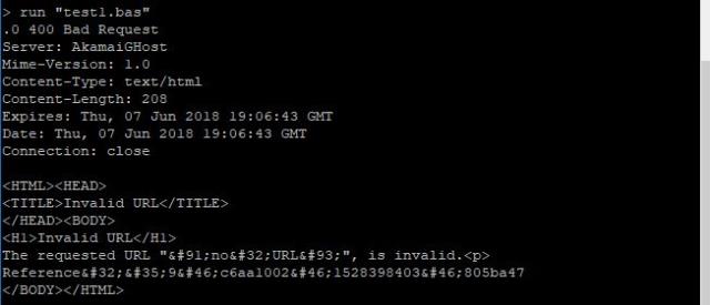

If the API request uses HTTPS such as DarkSky
Is there a way to get this to work without setting up a PHP server on the Pi and then using that to get and parse the data?
example
[code]https://api.darksky.net/forecast/APIKEY$/53.4399,-2.1065?units=uk2[/code]
When I use the code above I get this result
IF I change the get IP line to
a$=GetIP$("https://api.darksky.net")
Then I get this result
Yet if I do a tracert on https://api.darksky.net I get
Posted: 09:50am 07 Jun 2018
GETIP$ won't work with HTTPS addresses. Don't have a solution for this - but try omitting "HTTPS://" and see if you get the correct result - I get 34.194.205.2
You can also try putting the physical IP address into the TCP client command - remember to also use port 443Edited by matherp 2018-06-08
