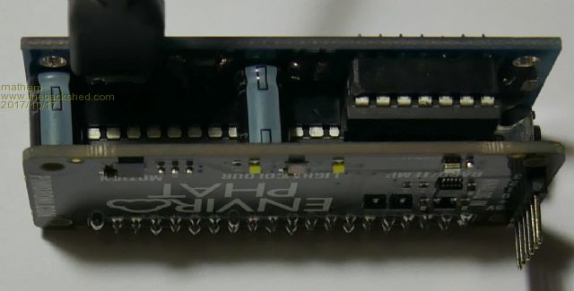

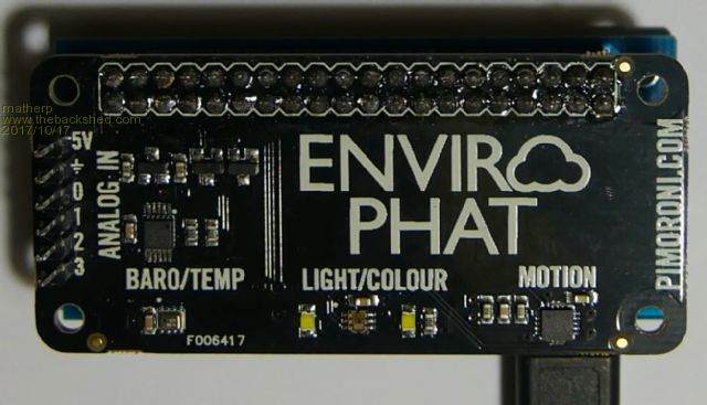

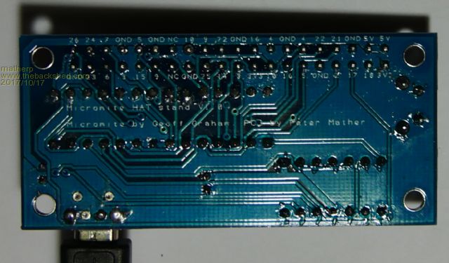

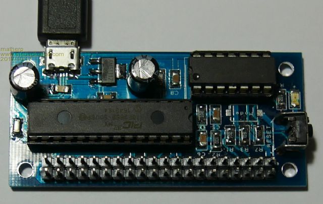

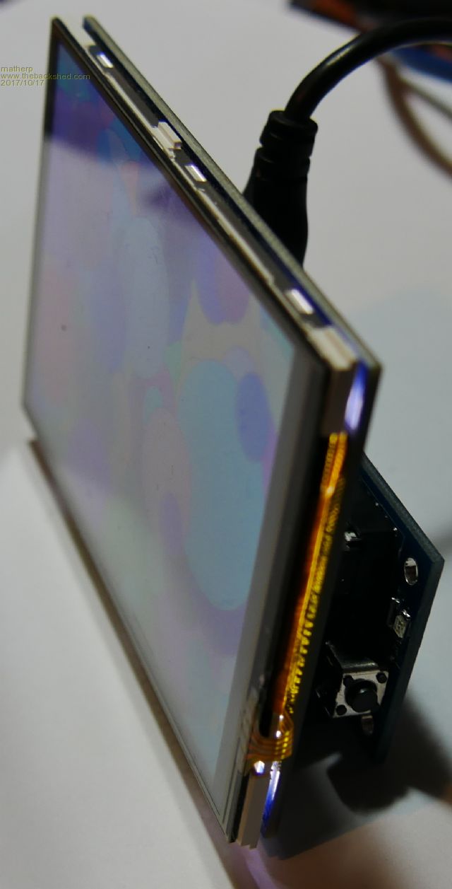

Here is the PCB made and populated and all works perfectly. If you want one contact WW or get some PCBs made. The last picture is with a 4" ILI9481 display and its loadable driver
sub mm.startup
ili9481 16,22,9,1
end sub
option touch 10,5
Gerbers:
2017-10-17_175812_HAT_stand.zip
Schematic:
2017-10-17_175923_schematic.pdf

Found a typo on the silkscreening: pin 22 of the 40 pin header was labelled 22 instead of 2.
Corrected in these gerbers
2017-10-19_093510_HAT_stand.zip
Note this also affects the ILI9481 configuration - should be:
sub mm.startup
ili9481 16,2,9,1
end sub
