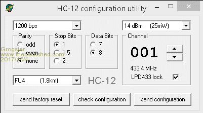

I use FU2 mode at 2400 baud (set by using Rob R's beaut config program).

@ lizby - I just used Rob's wonderful HC12 CONFIG utility.
Rob's HC12 Utility

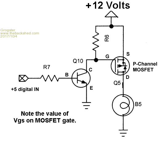

The NPN+MOSFET idea is NOT mine, I stole it from the web and also other members here I think pointed me to this idea way back when.
Here is an image of the same circuit I stole from Google Images:
This was what I have been using up until now, but it requires four extra SMD parts.
It is a high-side switch for just about anything with a common-ground.
I used 1k for R7, 100k as the R6, the NPN I used was an FMMT493 in SOT-23 flavour, and the MOSFET I used was a DMP2305 also in SOT-23. This GIF shows the MCU input as 5v, but it works just fine with 3v3 too. Hope that helps.
EDIT: Oh, BTW, no you can't mix the modes between modules as you have found out. ALL modules MUST work in the same mode or different networks of the same mode. The baud-rate and protocol(8N1 etc) can be changed from end to end, but NOT the operation mode. Hopefully you were not scratching your skull for too long before you worked that out! Edited by Grogster 2017-10-05

Just checking that to use the MOSFET to disconnect the circuit I could:
- use a pin from the MM170 to feed in as 3v3 where "+5 digital IN" is shown
- my 3x 1.6 AA batteries = 4V8 would feed instead of the "+12V"
- B5 would be the devices going to sleep
- use your R6 & 7
- common grounds
OK?

You can certainly do it with the NPN+MOSFET, but why not now use the AT commands and sleep the module without needing any extra components?
Sleeping current is only supposed to be 22uA or so, which is very low.....
But I grant you that the NPN+MOSFET concept will result in ZERO current drawn by the HC12 while the I/O pin from the MM is low. However, I doubt that a 22uA sleep current would DRASTICALLY effect your battery life, but then, this is only my 2c.

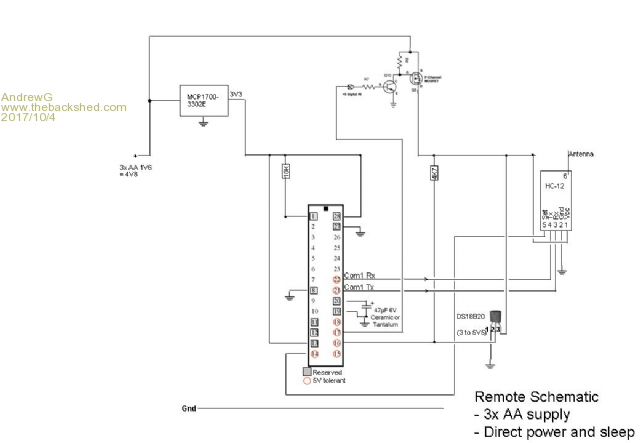

Hi Grogs.
Much appreciated. You may recall that even with the AT Sleep command I am only getting 4 weeks out of 2x AA batteries. I'm about to try 3x AAs. CaptianBoing suggested a MOSFET to cut the supply here.
This is the circuit I propose - any comments?
Cheers,
Andrew
Posts: 10110
Posted: 02:46pm 04 Oct 2017
Hard to read....
From what I can see, transistor arrangement looks right.
If you post as a GIF image and NOT a JPG, it will show up much clearer.
Make sure that you CLOSE the com port when you are not using it, so as to prevent the HC12 trying to run on parasitic power, which would add to your power drain.

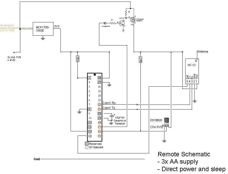

Grogster, thanks,
The GIF version is below (I never knew GIF was clearer yet 1/2 the file size?)
You'll see that the transistor arrangement is ~ as per your diagram and that it cuts off the DS18B20 too.
Some circuits I've seen (eg the LCD Backpack) have lots of capacitors hanging off the MCP1700 - are they necessary?
The listing for the remote is below that - yes I Close the Comm port (or think I do).

If you are going to switch the Vcc to the module using the transistors, you don't need the SET line connection at all - unless you also setup the module inside your code.
Just SETPIN 17,DOUT(in your schematic above) and then PIN(17)=1 to turn the HC12 on, and PIN(17)=0 to turn it off.
IE: If you are using transistors to turn the module off and on, connect the MM I/O pin to the transistors. If you are using the HC12's SET line and AT commands to sleep the module, connect the MM I/O line to the HC12's SET line. You don't need both.
EDIT: Oh, and about the caps - no, you don't. It depends on what processor you are using, and it's specific requirements. Geoff's schematic for the LCD backpack etc, just show all the 100n decoupling caps beside each other for simplicity. With a standard 28-pin MM chip, there is generally only two 100n caps. The 1700-series regulator only needs 1uF of input and output capacitance to be stable. I tend to use 10uF for good luck, X5R MLC type.Edited by Grogster 2017-10-06

Hi Grogs -thanks. Good point about not needing both the "switch" and "AT+Sleep". I'll try to set up a test to measure the current with either and make a choice - I guess the switch will win.
Re the capacitors, my understanding from your comment is that it is preferable that I have 2x 100n (I have some ceramics) and 2x 10uF as per Geoff's schematic. I'll be using through hole and veroboard.
Thanks, Andrew
Posts: 10110
Posted: 11:35pm 04 Oct 2017
The MOSFET switch WILL win. Although the sleep current is tiny at 22uA or so, that is still 22uA if you want to get specific, and the MOSFET switch when off, will mean the HC12 will not be powered, so won't draw any current at all.
MCU's don't like dirty power, and failure to use the correct decoupling caps can(and does) cause some very obscure behaviour from most of them if you don't follow the datasheet's recommendations. For the DIL MM chip, normally just the two 100n's are all that is needed, placed as close to pins 13 and 28 as possible.
The PIC32 chip used on the E100 board uses eight 100n caps on all the different power supply pins, and as close as possible.
It all depends on the chip, and what it's datasheet says.

  Andrew_G said   2N7000 would work
2N7000, although ancient and primitive, exists cheaply in vast quantities - kind of like the Herring of the FET world - I love it!!! Because it is unrefined, 2N7000 (or the BS170) is a good choice generally as a VCC switch for low-medium current. Very high off resistance and low enough that it doesn't really matter when on with <200mA D-S (ish).
HOWEVER: you need a P-channel device for the circuit as shown, Dr.Google suggests a BS250., but you might like to hunt around for a more modern device if you are going to have to get one in specially - lower RDS, better VThresh etc.
You could use a 2N7000 and drive the gate directly from pin17 but be wary of the voltage drops with battery operation (and the pin floating for a few mS while booting before PIN(17)=0:SETPIN 17,DOUT). You have already seen the voltage go way down before things die. For example VThresh of 2N7000 can be 0.8V to 3.0V so you might find that on tired batteries, you can't provide a sufficiently HI voltage for the FET's gate - they get hot and decompose over time (maybe only seconds) if they are held in the amplification zone (roughly between the upper and lower limits of VThresh). Plus increased RDS (read lower current:thus:voltage) to the HC-12.
Using FETs as a switch is a great idea but needs a clean+fast transition between on/off/on. The MM edge is easily fast enough but if you get a lazy FET or low VDD/VCC it might not like the levels.
If you do run from a regulated 3.3v supply, you should generally avoid these problems but heads-up.
Something else you could try (but not if driving a 2N7000 direct), rather than the 3v3 regulator on the ~4.5 supply, tap the battery stack between cells 2 & 3 to provide the 3v direct to the MM from there. It will mean marginally heavier usage of the first two cells but you could eliminate the regulator and its quiescent current (plus its cost) and still run the HC-12 on 3 cells. The third cell would then form a kind of power boost when needed rather than being in-circuit all the time.
This thread has turned into an entirely enjoyable canter with experimentation and measurement - maybe this can help. Do some tests with varying VCCs and watch out for hot FETs!
EDIT: while you are at it, put a 100nF cap between pin 1 on the MM and GND to provide a better reset pulse (~1-2mS) and provide a bit of noise immunity.
Good luck and have fun!Edited by CaptainBoing 2017-10-06

Using these two techniques, (software sleep with the SET pin, and power switching with a FET) how quickly does the HC12 wake up? For example, how long does it take to go from sleep/off to transmitting a byte?
Also, in normal use, can the SET pin be left floating (unconnected) or must it be pulled high with a resistor?
Andrew_G
Joined: 18/10/2016
Posts: 917
Posted: 01:39pm 05 Oct 2017
Pete, two good questions!
1) Time to awake (or re-boot) and transmit data - I don't know (perhaps a clever TBSite might?) I couldn't see reference in the manual. I had always though it might be an issue (also the power required to do it) but since I'm only transmitting every 10, or even 30, minutes I haven't worried. When I eventually get my test working I'll try to check.
2) Pullup resistor to unused "Set" pin (#5). The manual says there is an internal 10k resistor (twice, in another spot it says 1k). I have three units operating. One has #5 connected and used to sleep it, two not connected - I cant discern any difference in behaviour.
Cheers, Andrew
