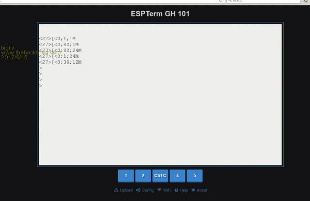

Example Mouse Usage:
To enable the Mouse in normal click mode use:
Print E$+"[?9h"
To disable the mouse:
Print E$+"[?9l"
Left upper corner click delivers:
[M!! = Hex 33,33 minus basevalue 32 gives 1,1
Lower right corner click delivers:
[Mp8 = Hex 112,56 minus basevalue 32 gives 80,24
This allows you to use any location on the screen as an input button

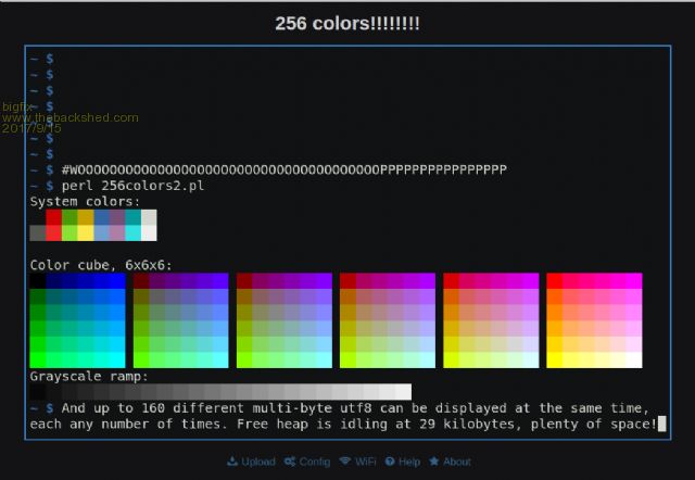

256 Colors, Cursor styles

Useful Code Snippet from Rob to test Mouse functionality:

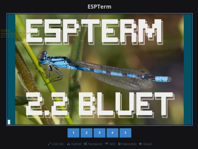

Image backgrounds - allow a DYNAMIC background behind Text Forground
Image background can be configured in the Terminal Settings form, or sent using an OSC command:
[Escape] = Chr$27
[Bell] = Chr$7
OSC 70 ; url ST -
eg. [Escape]]70;https://goo.gl/sh4dny[Bell]
is the damselfly from the above screenshot (source: Wikipedia).
The URL is resolved by user's browser, so HTTPS or even FTP can be used.
Animated gifs will work too.
Note: don't use this if you expect users to connect to the built-in AP,
they won't be able to access the image.
This feature is useful for: logos, process diagrams, pre-rendered UI elements, etc.
The URL can be max 100 characters long.
The image will be centered and scaled to fit the screen. Note that about 6px on either side of the screen is used for the margins and the screen size, resp. aspect ratio, may slightly vary with the font used.
Don't expect pixel-perfect graphics, if you need that, use any of the Unicode line / box drawing characters.
The image will be visible where the default background color is used - use [Escape][0m or [Escape][49m to reset to the default color.
The background color around and behind the image is your configured default background color
Clear the background URL box or send [Escape]]70;[Bell] if you want no background image.

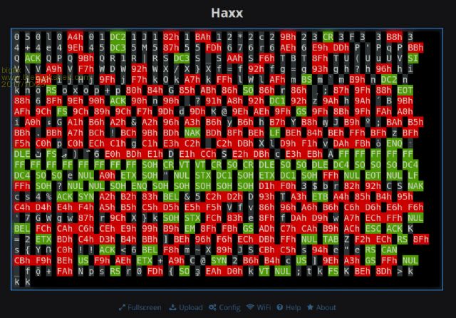

Debug parser - select in terminal settings.
this parser captures all input and instead of interpreting the sequences, shows them right on the screen.
Green codes are low ASCII control characters, red are corrupt UTF-8 sequences.

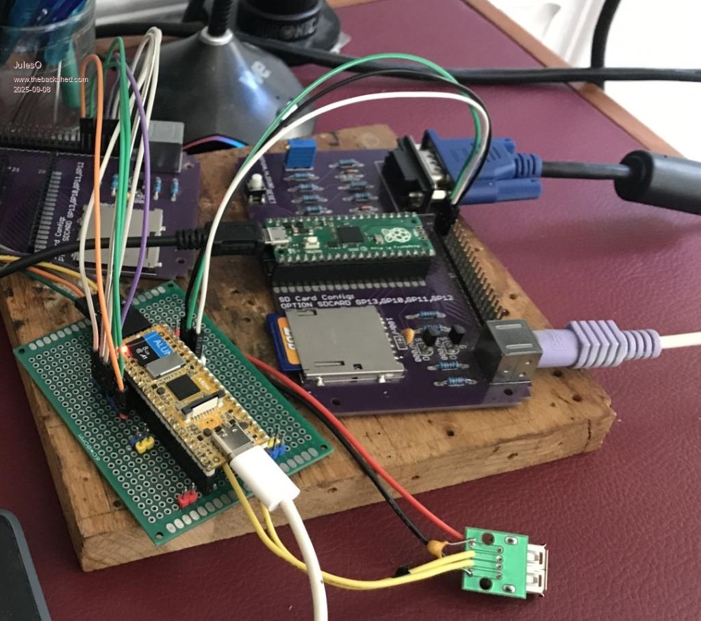

Hello everyone, and thank you for welcoming me to this amazing forum! You’re all fantastic and a daily source of inspiration for me.
I’m Jules, 35 years old, a self-employed business lawyer with a background in legal history academia—but I’m also passionate about IT! I started my career by programming legal document matrices at one of France’s largest legal software companies (the largest, actually), and my love for IT has never left me.

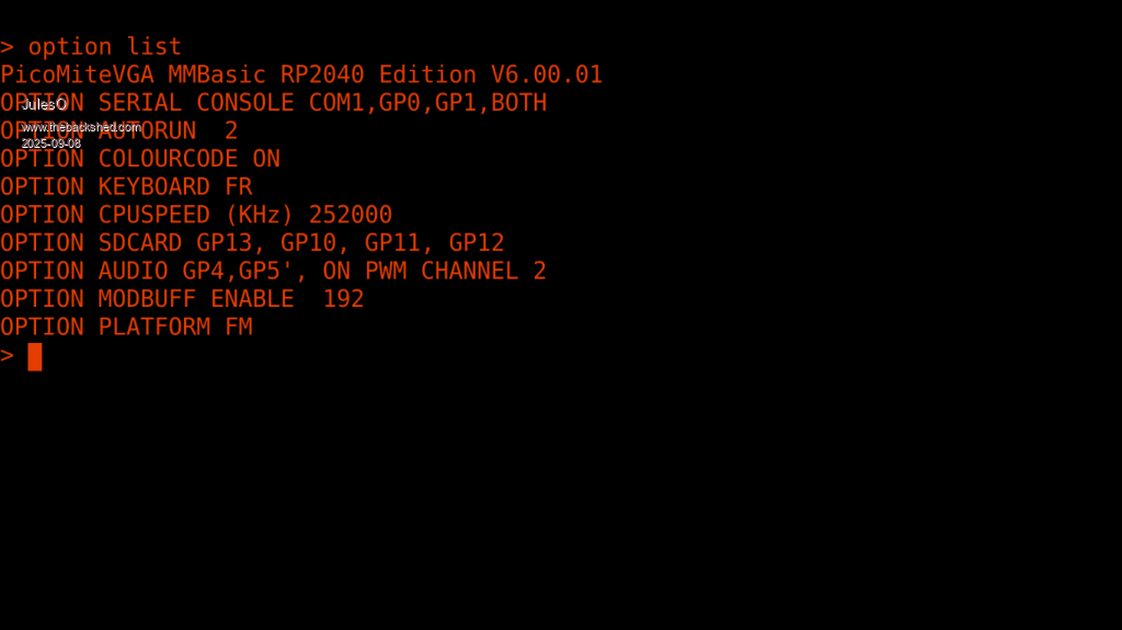

I’m reviving this post because I recently discovered ESPTerm and built one for myself. However, I can’t get it to work with my beloved PicoMite VGA! Is there a way to route the USB serial connection to one of the Pico’s serial ports?
That would be awesome for remote control of the PicoMite VGA! I’m currently trying to program a minimal VGA driver for the Milk-V Duo 64M, so I can then tinker with the processor’s RTOS core and—hopefully—encourage you guys (well, mostly the famous @Thwill) to port MMB4L to RISC-V! ;)
I needed a serial terminal to access U-Boot during the Milk-V Duo’s boot process, so I could load new programs onto the RTOS core. However, my attempts with MMBASIC were blocked by my inability to handle typical VT100 terminal sequences. I managed to get output from the Milk-V Duo and send characters to it, but I had no backspace, Ctrl+C, or F10 functionality... So I switched to ESPTerm.
I'm also develloping a text game adventure (with pictures and sounds!) for the picomite VGA that i'd like to show you once I'll finished the whole story ! It basically is a remake of the dracula's story where you, as a young clerk, go to Dracula's castle and have to kill him before the night rise.
Thanks again to Geoff and Pete and to everyone for your work, insights, and shared experiences!
