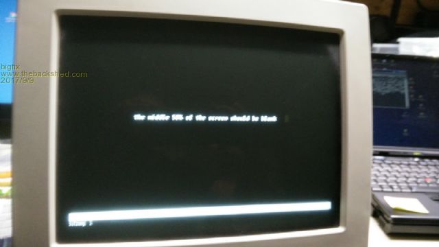

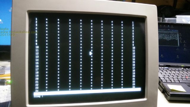

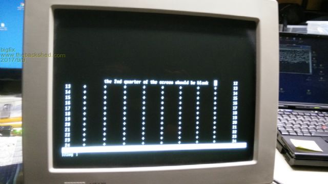

Rob,

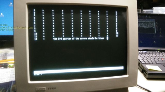

my "real" VT100 are deep buried in storage - would take hours to get them
I grabbed a VT420
Surprise - powered up after being 20 Years on shelf...
Put it into VT100 Mode in setup, even VT100 ID
Next challenge was to get a 3V TTL to V24 25 Pin Female converter done
After some hickups with undocumented chinese modules it finally worked
Even when I turned off smooth scroll the VT420 still showed some buffer overrun garbage with your program
DEC Terminals really depended on Xon/Xoff - which we do not have at MMites...
- had to set it to 9600 Baud - finally worked
MMite is a LCD Backpack, original Version, MMBasic 5.2
Some screens look different to the comments
I did not analyse the CSI sequences yet - just runned the program
I only post the first & the "failing" screens
cheers
Guenter

  bigfix said  Some screens look different to the comments
cheers
Guenter
excellent, that shows that i don't need to modify the erase functions to respect the scroll region, though i am a little surprised at this behaviour. none of the online material i looked at made it clear about what the expected behaviour was.

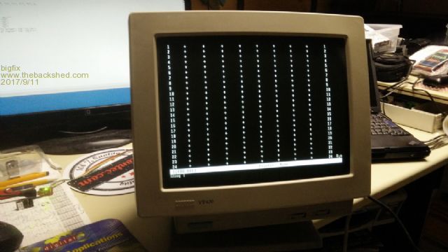

Posted: 10:31pm 10 Sep 2017
Rob,
works exactly as you described on the VT420 at 9600 Baud
(Video on request only )

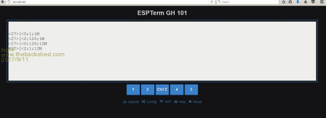

Posted: 02:54am 11 Sep 2017
excellent, that has enabled me to now finalize how i handle cursor movement commands.
btw, how well does the following work with ESPTerm?
Const ESC=Chr$(27)
Print ESC "[?9h"; ' enable mouse reporting
Print ESC "[?1015h"; ' select URXVT encoding (if available)
Print ESC "[?1006h"; ' select SGR encoding (if available)
Do: A$=Inkey$: Loop Until A$<>""
If A$=Chr$(27) Then Print
If Asc(A$)<32 Then Print "<" Str$(Asc(A$)) ">"; Else Print A$;
Loop Until A$=Chr$(26)
Print ESC "[?1006l"; ' disable SGR encoding
Print ESC "[?1015l"; ' disable URXVT encoding
Print ESC "[?9l"; ' disable mouse reporting
it makes use of alternative encoding for the mouse location reporting - SGR (1006) is the preferred reporting method, URXVT (1015) is ok but not great, while the default encoding can not encode beyond column 95 if using 7-bit characters.

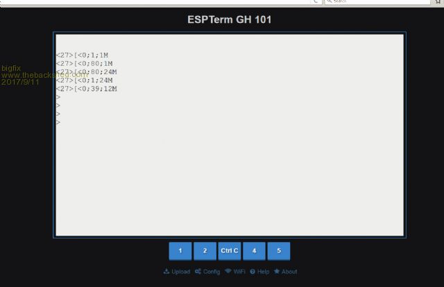

Posted: 11:11am 11 Sep 2017
Tested it on 1.01 ESPTerm
One issue I found - Mouse stays enabled ??
Need to investigate
Anyhow, this is the output clicking on the 4 Corners & Center
When I use the right mousebutton then first number changes from 0 to 2
It also works excellent on an Android tablet with touch
Wide Terminal with 120 Characters:
