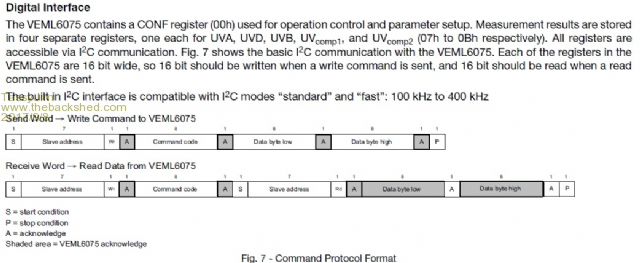

I have been slowly working on building my own weather station and wanted to use a standard Micromite to read a few sensors and send that data via rf to a reciever inside for further processing. One of the sensors is a Vishay VEML6075 UV sensor and it has a I2C interface. It uses registers that are 16 bits wide instead of 8 bits and requires 16 bit transfers.
Here is the data sheet... Vishay VEML6075
At the top of page 6 it says
"Each of the registers in the VEML6075 are 16 bit wide, so 16 bit should be written when a write command is sent, and 16 bit should be read when a read command is sent."
Using a raspberry pi and python I was able to use bus.write_word_data and bus.read_word_data to do the 16 bit read and write.
What I need to know is if the micromite can do 16 bit I2c read and write since I would like to use it to read my sensors. The VEML6075 is the only one that uses 16 bits instead of 8. I don't currently own a micromite so I can't test anything.
Thanks Max

Not the same thing. This sensor uses 16 bit transfers or words. Your example uses 8 bit transfers or bytes.

I must be reading the data sheet incorrectly.
It has 16 bit resolution and holding registers, in the timing diagrams 16 bit transfers appear to be normal HI - LO bytes transfers. Which is the norm for R/W 16 bit values in most sensors.
Once again, excuse my ignorance if I'm reading that wrong.
Mike.

Posted: 05:51pm 07 Sep 2017
Reading the datasheet shows that the data is sent/read in Low byte/High byte format to make up the 16bit word. Or in other words, 2x 8 bit transfers, not 1 x 16 bit transfer.
The MM should do it fine, and although I haven't tested it, Phil's code should be ok.

Posted: 06:35pm 07 Sep 2017
The data sheet shows the data being sent in 2 8bit bytes with the ACK between them.
All they want is for you to read/write both high and low bytes at the same time.

Posted: 06:59am 08 Sep 2017
I rewrote the code to read the raw data and have it working, so the micromite should be able to do it to. Now if I can just figure out how to finish the code to calicate the UV index. My brain is tired.
