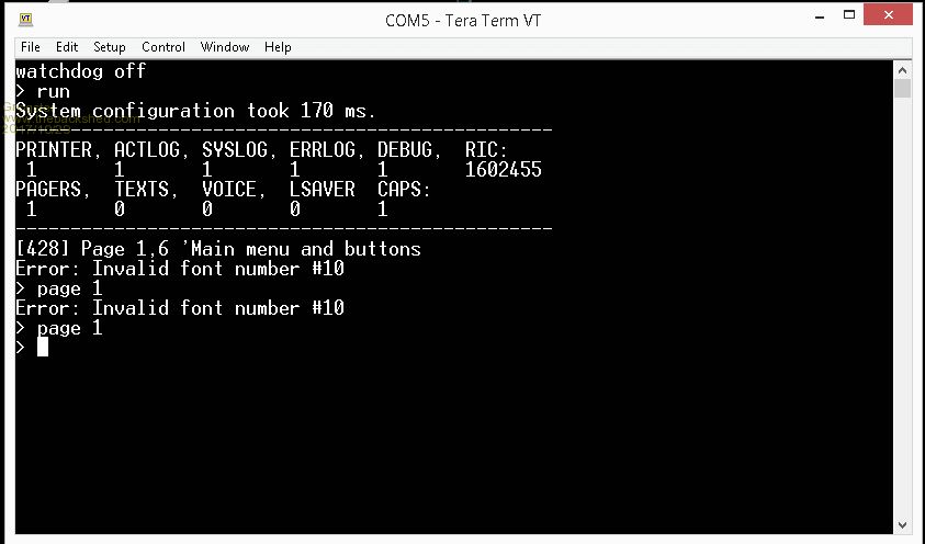

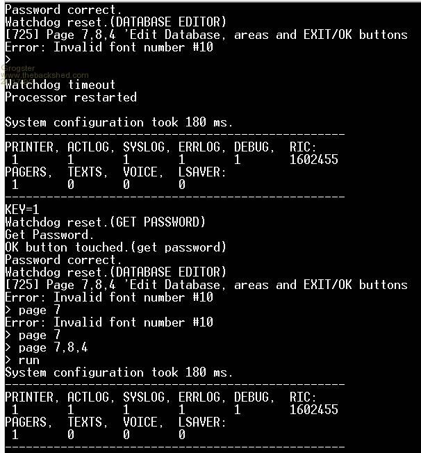

Anyone else seeing this?
MM+ ver 5.0405
I keep getting this message when calling GUI pages - but I am not using any font #10.
Font #10 does not exist, either in the library or in any other form.
Font #10 is not referenced in any GUI pages, including pages 7, 8 and 4.
I do use fonts 7,8 and 4, but I don't use a font #10
Fonts 7 and 8 are in the library.
EDIT: Relevant GUI page code....

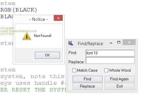

EDIT: MMEDIT finds no reference to font #10 anywhere in the code:

Posts: 10114
Posted: 03:15pm 31 Aug 2017
Hi there. Thanks for posting. It's nice to know I am not insane.
Yes, this is indeed very interesting.
I reflashed the PIC32 to 5.0405 to be totally sure I did not have corrupted flash or something, but same problem, so I suspect a bug.
I have been able to narrow it down.

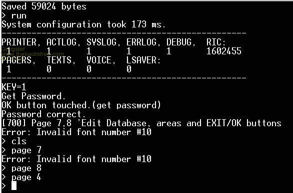

In line 700 - PAGE 7,8,4, if I make that PAGE 7,8, it falls over with the same error, but if I make that PAGE 7 this works just fine - no font #10 error message.
Naturally, this means some pages of GUI are not there, but the purpose of this test, was to try to home in on where the problem is.
Next thing to try was some console commands, and it seems to be directly linked to my attempts to call GUI page 7. I can call any other page I like - no problems, but as soon as I call page 7, I get the error:
EDIT: MOST strange. Now I put the PAGE 7,8 back and it worked. So I changed it again to PAGE 7,8,4 and now THAT works, and everything works as it should.
I have not altered the code(other then playing with line 700), I have not changed the library. WTF? Edited by Grogster 2017-09-02

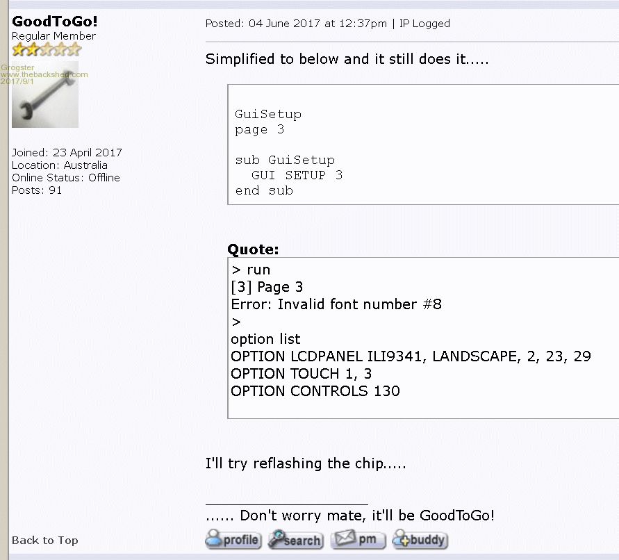

Sounds remarkably similar to the issue I had back in June..... Page 3 invalid font
Never got it sorted out, ended using a different page number....
Good luck!

Posts: 10114
Posted: 06:21pm 05 Sep 2017

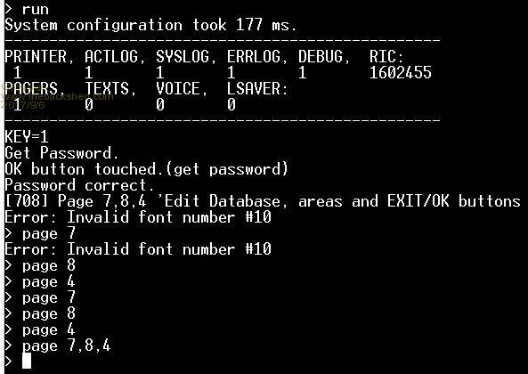

Here is another shot of the problem - it appears to be self-correcting, but only from the command-prompt:
Note that it fell over at the Font #10 thing again, and that typing PAGE 7 results in the error. Typing PAGE 8 works. Typing PAGE 4 works. Typing PAGE 7 a 2nd time, then works as it should. Typing the full PAGE 7,8,4 then works fine. Running the code then works fine.
Not sure if that helps at all, but feels like a problem calling the PAGE command more then once for certain pages. PAGE 7 was the problem last time too - not sure if that means anything.

Blanked the MM+, loaded with below and.......
memory
Flash:
1K ( 1%) Program (7 lines)
99K (99%) Free
RAM:
0K ( 0%) 0 Variables
0K ( 0%) General
101K (100%) Free
> list
GuiSetup
Page 3
Sub GuiSetup
GUI SETUP 3
End Sub
> run
[3] Page 3
Error: Invalid font number #16
Hope it helps with the bug squashing
GTG!
...... Don't worry mate, it'll be GoodToGo!

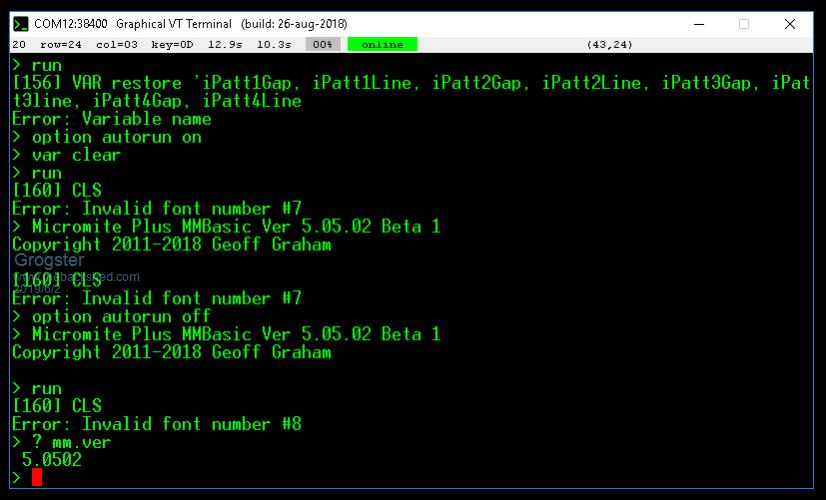

I also experienced this happening a couple of days ago on my E100 project. I upgraded 5 boards to V5.04.05 a few weeks back but didn't get much time to work on my timer project. The timer is mostly up and running but I'm still trying to develop a couple more features using trial and error programming through MMIDE. In my program there is an initial selection menu then it displays a warning page before running the selection. I know that it had worked several times up till this week so when Error: Invalid font number #10 came up on the screen I thought my last program changes must have caused the problem. The error pointed to the Page 30, 31 line in the code below. This was not a recent change.
CLS
Page 30, 31 'WARNING - PRESS TO FACE TARGETS
If FLAG_1 = 0 THEN
Loop
EndIf
I tried with just “Page 30” on the line and the program ran. I tried with just “Page 31” on the line and the error returned. This is the code for 31:
GUI SETUP 31 ' TARGET WARNING_PAGE
Font 4, 2
GUI BUTTON WARNING_GO, "PRESS TO FACE TARGETS", 30, 120, 740, 240, RGB(BLACK), RGB(RED)
I tried changing the font thinking that this was the problem but no joy. The E100 PCB I was using had been damaged when I tried to solder in my first SMD PIC so I tried another board but it also showed the same problem. That’s when I suspected that V5.04 might be causing the error. I’ve gone back to V5.03.02 and it seems to be working correctly on both boards.
When the error began to appear I had been using VAR SAVE and VAR RESTORE for the first time. I don’t know if this caused it.
Posts: 10114
Posted: 08:46pm 18 Oct 2017
Hi there.
I can confirm that I have had an email from Geoff on this matter, and this invalid font issue IS on his bug-list for the next release, but he mentioned that won't be for at least a month or so - he's away seeing the world again.
