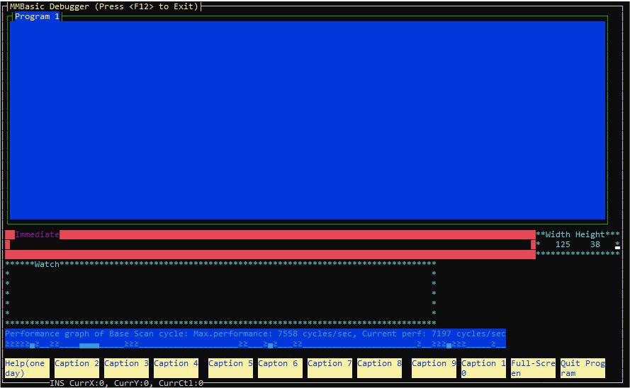

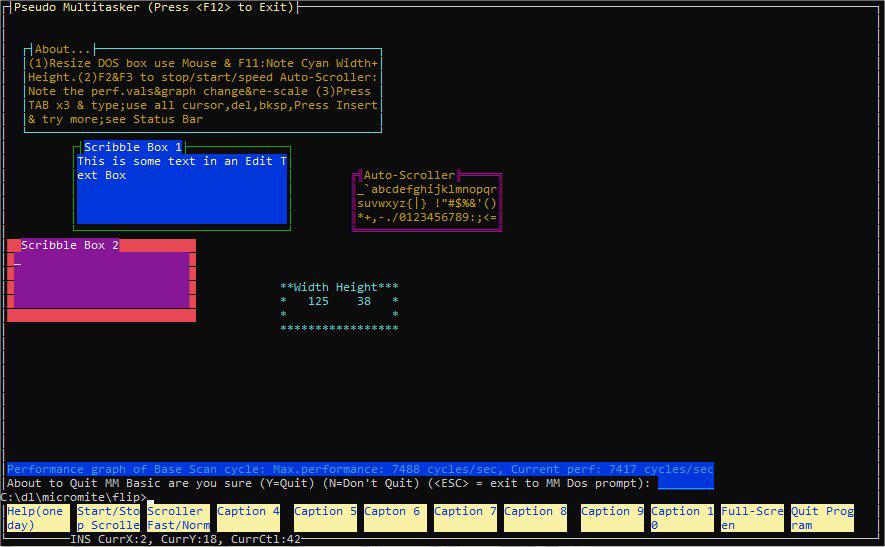

Phil--this is quite fine and fun work. Very compact code, but I could follow it well. It deserves more attention--perhaps screen shots would help. This is what you get when you run the code as-is:
This is after I spent about an hour puzzling things out and trying to make my own windows:
(Warning--there is no code to do what the window headings imply can be done.)
This is just what I've been looking for (and it's been sitting here neglected all along.)
I've started to try to port it to the CMM2--initial issues are with cursor (I think I got that) and then with the other problems which arise from having mm.hres and mm.vres in pixels rather than in characters as in DOS MMBasic.
Your comment in the other thread that you've made enhancements is intriguing. Can you share them? Immediate thoughts would be vertically scrolling lines and more enhanced editing.
Thanks again for this powerful piece of code--50 windows (well, in theory).
