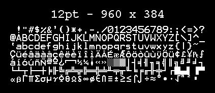

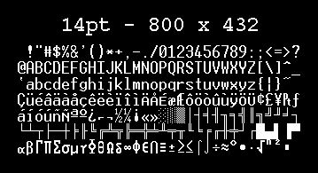

have just done a bit of checking, and turns out i was quite wrong about having to stick to only 9 point. see the below screen grabs at 9, 12, and 14 points:
i'll work on making these three options selectable in some way.
rob :-)

here's a new beta that allows for 3 possible font sizes: 9pt (default), 12p, and 14pt.
2017-08-19_134404_demo_20-aug.zip

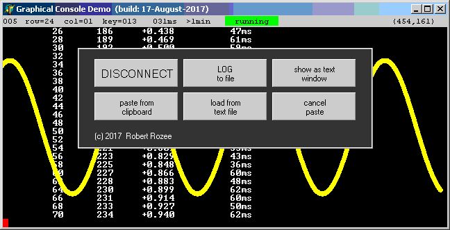

the bottom right button on the control panel (accessed with a right mouse click) now shows/hides a small floating command window. this window displays VT and GFX commands as they are processed, marked with pass/fail. the command window remembers the last 1000 or so commands with command strings only added when the command window is visible.

another beta, this one is getting close to a finished product. the 'action button' panel has now been replaced with a more conventional right-click menu, with several of the alt-key functions moved there.
it is now possible to set the default foreground colour. this setting, along with font size and last successful comm port string are saved in the windows registry. there have also been numerous small bug fixes and enhancements made under the hood.
a Quickstart Guide has been added, detailing basic usage.
