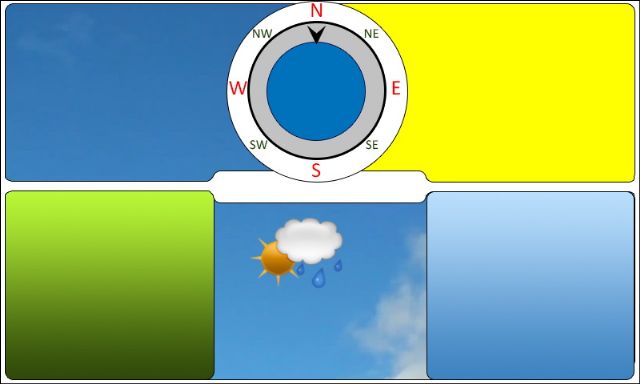

I finally started working on the weather station again tonight, with a nice new look to it and the Big Ben clock is gone.
My brain will not work though (YES I have read both manuals)
How do I simply print the time on the display?
I want to display it in a white box in the middle of the screen and get the time from the RTC

What I want to do is display the time and ideally date/day on the white box in the middle of the pic - I might need to make the box bigger though or I might need to only put the time there -
I'm using a 7" display and an E100 board
