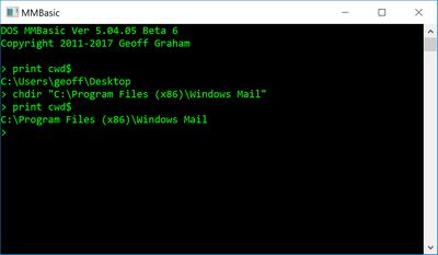

Rob, Beta 6 has no problem with spaces or long paths:
MMBasic is a programming language. So if there is to be a conflict with the "IDE" the programming aspect will take precedence. Neither should it act differently for different commands or at the command prompt.

  robert.rozee said   might have found one of the problems: it looks like chdir$ internally provides quote marks at begining and end of the supplied string, so the string should NOT already have the quote marks present.
chdir$ does not add quotes, it just takes the string as presented (with spaces, etc) and changes to that directory. If you add quotes you are adding illegal characters to the directory path.
  panky said  It appears that chdir will only accept quoted text as an argument directly and ONLY non-quoted text when a string variable is the argument. Edit: This appears to be true for all the files related commands eg. FILES etc.
BASIC requires quotes around string constants but they are not part of the string - they just tell the interpreter that the enclosed text is a string. For example A$ = "C:\temp" sets A$ to C:\temp not "C:\temp".
All file related commands use strings without embedded quotes. The following are the same:
CHDIR "C:\temp"
and
A$ = "C:\temp" : CHDIR A$
my mistake there, getting confused between all the quote mark rules! for the benefit of others: LFNs (long file names) passed as parameters on the windows commandline require quote marks around them. so at the console prompt you'd need to type:
cd "C:\Program Files"
in order to indicate that you are just passing a single parameter to cd, a parameter that contains a space.
the string MM.CmdLine$ potentially contains quote marks at the beginning and end, placed there by windows. if you are doing something with it that involves the SYSTEM command, then these enclosing quote marks usually need to be maintained. if you are using it with a command internal to mmbasic (such as chdir$) then these quote marks need to be stripped out.
in all of the above i am NOT talking about the quote marks used to delimit a string literal. it just happens that both windows and mmbasic use the same character (") as a means of enclosing strings. in the case of windows this is done purely to allow the string to contain space characters without creating confusion.
rob :-)
