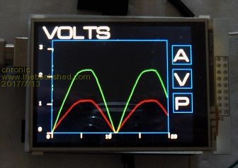

The program scales and sends data to the display via spi exchange, as sequential y data points (mm).
DO WHILE ( i < 121 )
val = FLOAT ( dat(i,1) )
val = val * sclfac
mm = IFIX val + 32
CALL xsptek ( nn, mm, bt )
The default sends the two channels as two lines. The data is offset 32 to move it out of the ASCII control codes. The display program is directed by some embedded control codes.

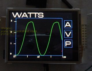

The user can select option A,V,P (amps, voltage,power) on the touchscreen and the
choice is sent back to the main program. This alters the program flow accordingly. So, if "P" (power) is selected, instead of the volt and amp values being sent, the program multiplies the two data points
(amps, volts) to give the power value, and the result is scaled and sent.
val = FLOAT ( dat(i,1) ) * sclfac
val = FLOAT ( dat(i,2) ) * sclfac * val
val = val * 0.02
mm = IFIX val + 32
and the display now shows the power instead

The screen here is displaying a 10kHz signal on the two input channels, with the screen about a millisecond wide. The pic32mx170 A/D can be pushed a fair bit further if needed but that is not intended here.
so I guess that is proof of concept OK.

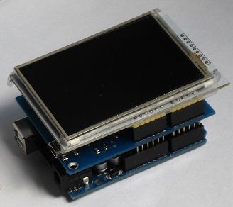

This sketch is a standalone demo. It runs on a uno with a parallel drive 240x320
lcd shield eg from Jaycar. In the code, values are put into the buffer artificially instead of from the spi client interrupt. It runs a slow sweep (approx ten seconds) using the analog value from A5. (It is deliberately plain and simple, and is not meant as an example of the best way to achieve a sweep display, but may be of interest.)
For this - The buttons are cosmetic only. The touchscreen parameteres will
probably have to be tweaked, and I set the font back to a standard one.
It is not polished as I have had eyesight probs lately (pending fixing)
and it will have to do. The suggested name is Vit10demo1,
copy/paste into a new sketch and use "save as" .

strcpy(obj4.newtxt, "b" );
strcpy(obj4.oldtxt, "b" );
strcpy(obj5.newtxt, "c" );
strcpy(obj5.oldtxt, "c" );
strcpy(obj6.newtxt, "d" );
strcpy(obj6.oldtxt, "d" );
tft.setTextColor(WHITE);
for ( numobj = 0; numobj < maxobj; numobj ++ )
if (screen[numobj].flags.visible == 1)
if (screen[numobj].obtype == 1) // 1 = text
tft.setCursor(screen[numobj].xloc, screen[numobj].yloc);
tft.println(screen[numobj].oldtxt);
else if (screen[numobj].obtype == 2) // 2 = button
tft.setCursor(screen[numobj].xloc + 6, screen[numobj].yloc - 10);
return;
void updatescreen() {
byte nxtchr = 0;
byte linenum = 1 ;
if ((screen[numobj].flags.repaint != 0)
&& (screen[numobj].flags.visible == 1))
if (screen[numobj].obtype == 1) // 1 = alphanumeric field
if ( strcmp (screen[numobj].oldtxt, screen[numobj].newtxt) != 0 )
nxtchr = 0;
while ( screen[numobj].oldtxt[nxtchr] ==
screen[numobj].newtxt[nxtchr] )
tft.print(screen[numobj].oldtxt[nxtchr]);
nxtchr ++ ;
tft.setTextColor(BLACK);
while ( screen[numobj].oldtxt[nxtchr] != '\0' )
nxtchr ++ ;
tft.println(screen[numobj].newtxt);
strcpy(screen[numobj].oldtxt, screen[numobj].newtxt);
if (screen[numobj].flags.enabled == 1)
objboilerplate ( numobj );
tft.print(screen[numobj].newtxt);
else if (screen[numobj].flags.enabled == 0)
{ tft.drawRoundRect(screen[numobj].xloc,
(screen[numobj].yloc - screen[numobj].ysize),
screen[numobj].xsize, screen[numobj].ysize, 8 , GREEN );
tft.setTextColor(DIM);
screen[numobj].flags.repaint == 0 ;
else if (screen[numobj].obtype == 3) // 3 text block (/menu)
nxtchr = 0;
tft.setFont();
// tft.setFont(µgmm18pt7b);
tft.setFont(&FreeSans12pt7b);
tft.fillRect(screen[numobj].xloc + 1,
(screen[numobj].yloc - screen[numobj].ysize + 1),
screen[numobj].xsize - 2, screen[numobj].ysize - 2, BLACK );
screen[(linenum ++ + 1)].yloc - 10);
while ( nxtchr < count )
tempchar = stage[nxtchr];
if (tempchar == 13)
if ( screen[numobj].flags.text == 1 )
+ linenum ++ * 28);
else // menu vertical
else
tft.print(tempchar);
nxtchr ++ ;
objboilerplate(numobj);
tft.setFont(&FreeSans18pt7b);
else if (screen[numobj].obtype == 4) // 4 text block (menu)
nxtchr = 0;
//tft.setFont();
if (tempchar == 13)
else
nxtchr ++ ;
//tft.setFont(µgmm18pt7b);
// tft.setFont(&FreeSans12pt7b);
else if (screen[numobj].obtype == 5) // 5 = sweep
yl = atof(screen[numobj].newtxt) / 3.3 * 180 ;
rx = 31 + j ;
ry = 222 - yl ;
darkry = dark[j];
if ( j == 0 ) {
oldrx = 31 ;
oldry = ry ;
darkry = ry ;
darkoldry = ry ;
tft.drawLine(oldrx, darkoldry, rx, darkry, BLACK);
// tft.drawLine(oldrx, oldry, rx, ry, RED//);
tft.drawLine(oldrx, oldry, rx, ry, GREEN);
oldrx = rx ;
oldry = ry ;
dark[j] = ry ;
darkoldry = darkry ;
j++ ;
if (j == 239 )
j = 0 ;
else if (screen[numobj].obtype == 6) // 6 = trace
j = 0 ;
nxtchr = 0 ;
yl = stage[nxtchr] - 32;
rx = 30 + j * 2 ;
ry = 222 - yl ;
// if (ry > 200 ) ry = 220 ;
darkry = dark[j];
if ( j == 0 ) {
oldrx = 30 ;
oldry = ry ;
darkry = ry ;
darkoldry = ry ;
if (nthtrace > 0 ) {
oldrx = rx ;
oldry = ry ;
dark[j] = ry ;
j++ ;
if (j == 120 )
j = 0 ;
nthtrace ++ ;
nxtchr ++ ;
screen[numobj].flags.repaint = 0 ;
nthrecin = 0;
//memset(stage, '\0', 120);
return ;
void act_stateA() {
return ;
void act_stateB() {
return ;
void act_stateC() {
return ;
void act_stateD() {
return ;
void boilerplate() {
byte numobj ;
tft.fillScreen(BLACK);
//outlines
if ( screen[numobj].obtype == 2 )
if ( screen[numobj].obtype == 3 )
tft.drawRect(screen[numobj].xloc,
screen[numobj].xsize, screen[numobj].ysize, RED );
if ( screen[numobj].obtype == 5 )
screen[numobj].xsize, screen[numobj].ysize, BLUE );
// tft.drawLine(31, 223, 31, 40, BLACK);
axetics();
if ( screen[numobj].obtype == 6 )
axetics();
return ;
void objboilerplate ( byte nthob )
if (screen[nthob].flags.visible == 1)
if ( screen[nthob].obtype == 2 )
tft.drawRoundRect(screen[nthob].xloc,
(screen[nthob].yloc - screen[nthob].ysize),
screen[nthob].xsize, screen[nthob].ysize, 8 , GREEN );
if ( screen[nthob].obtype == 3 )
tft.drawRect(screen[nthob].xloc,
screen[nthob].xsize, screen[nthob].ysize, DIM );
if ( screen[nthob].obtype == 5 )
screen[nthob].xsize, screen[nthob].ysize, BLUE );
//tft.drawLine(31, 223, 31, 40, BLACK);
axetics();
if ( screen[nthob].obtype == 6 )
axetics();
void axetics () {
// vert axis tics
tft.drawLine(20, 222, 30, 222, WHITE);
tft.drawLine(20, 167, 30, 167, WHITE);
tft.drawLine(20, 113, 30, 113, WHITE);
tft.drawLine(20, 59, 30, 59, WHITE);
//hori tics
tft.drawLine(30, 223, 30, 230, WHITE);
tft.drawLine(90, 223, 90, 230, WHITE);
tft.drawLine(150, 223, 150, 230, WHITE);
tft.drawLine(210, 223, 210, 230, WHITE);
tft.drawLine(270, 223, 270, 230, WHITE);
// tft.print("0", 20, 225);
// tft.print("10", 140, 225);
// tft.print("20", 260, 225);
// tft.print("ms", 275, 215);
tft.setFont();
tft.setCursor(3, 210);
tft.print("0");
tft.setCursor(3, 155);
tft.print("1");
tft.setCursor(3, 100);
tft.print("2");
tft.setCursor(3, 45);
tft.print("3");
return;

The self-running example runs with just the arduino / genuino uno and parallel drive lcd shield.
The lcd shields are cheap on the net. Adafruit originally had a parallel drive lcd shield version but changed it to back to serial, I used one from Jaycar ie
parallel lcd
which has the blurb and libraries etc as well
Edit - [ example was on arduino v 1.8.3 ]Edited by chronic 2017-12-17

  chronic said   The self-running example runs with just the arduino / genuino uno and parallel drive lcd shield.
parallel lcd
I got 5 of those from ebay reseller (total 28$ AUD) and they work great with My ARDUINO compatibles (Not the WEMOS D1, not enough IO pins). Even works with the Arduino MEGA2560 which is great as they have still lots of spare IO. I am experimenting with making them a slave I2C unit for remote displays. The LCD + UNO costs less than $10 in total making for a cheap remote display. I would/could use with a Micromite/Maximite or even the many Duinomites I own (pinout is compatible with the shield) , but the code library is off-the shelf for the LCD on the arduino. cFunctions in MMbasic is just TOO DAMN convoluted for anything more than a simple function. C/C++ coding is a joy on the Arduino. I even have one of those IL1341 .96inch OLED displays connected to a BareBones ATMEGA328P Chip (<$2) running with internal 8Mhz clock and NO external components.
Edited by djuqa 2017-12-27
