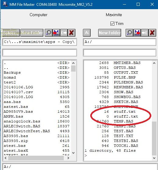

Posted: 09:26pm 10 Jul 2017
More playing
I added a bit more code
  Quote   OPEN "stuff2.txt" FOR APPEND AS #1
PRINT #1, "line 1"
' something in here screws up and it crashes
PAUSE 200
' x = y/0
PRINT #1, "line 2"
CLOSE #1
PAUSE 1000
PRINT #1, "line 1"
PAUSE 200
x = y/
0
PRINT #1, "line 2"
CLOSE #1
And ran it.
Not only was the two lines from this run there but also the first line from the previous program.
  Quote  line 1
line 1
line 2
I assume that there is a lonely "line 1" sitting there in nowhere land from the error in the second run through the printing.
There might be a timed flush at play somewhere.
And if you go back and enter CLOSE #1 at the command prompt, the extra bytes get written.
This is even after opening the file with XMODEM in between crashing and closing.
All my testing was with a MMX running V5.4Edited by TassyJim 2017-07-12
