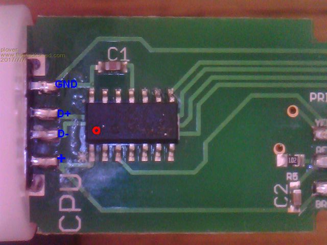

Here is a pic with USB lines annotated.
Should just add that I am reasonably sure I have identified the chip as the 1455 but no guarantee as it is very hard to read after removing a dab of paint hiding details.
