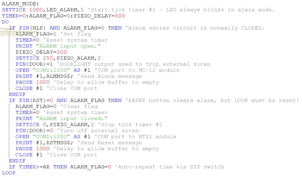

EDIT: Here is the test alarm code that is doing this very odd com-port behaviour.
It is indeed possible, that the HC-12 I am using is crook or something, so I will be checking what is indeed coming out of the MM COM port on the logic analyser tomorrow - perhaps the HC-12 is unstable and is generating the problem internally? Anyone seen that before?Edited by Grogster 2017-07-04

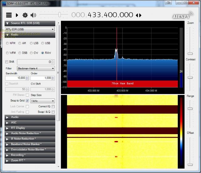

My hypothesis is that your HC-12 is picking up noise (or another close-by 433MHz transmitter) and keeps sending data to your MM.Edited by piclover 2017-07-04

I have seen HC12s pick up crap from nearby systems... can you try them on another channel?

Hadn't thought of using my scanner; I've got a similar older Uniden here.
What I do find very useful though is a Software Defined Radio.
Cheap USB TV receiver dongle ;
Then this Software.
Gives me a cheap & dirty spectrum analyser.
A real one would be nicer, but a bit more than $15.00.
