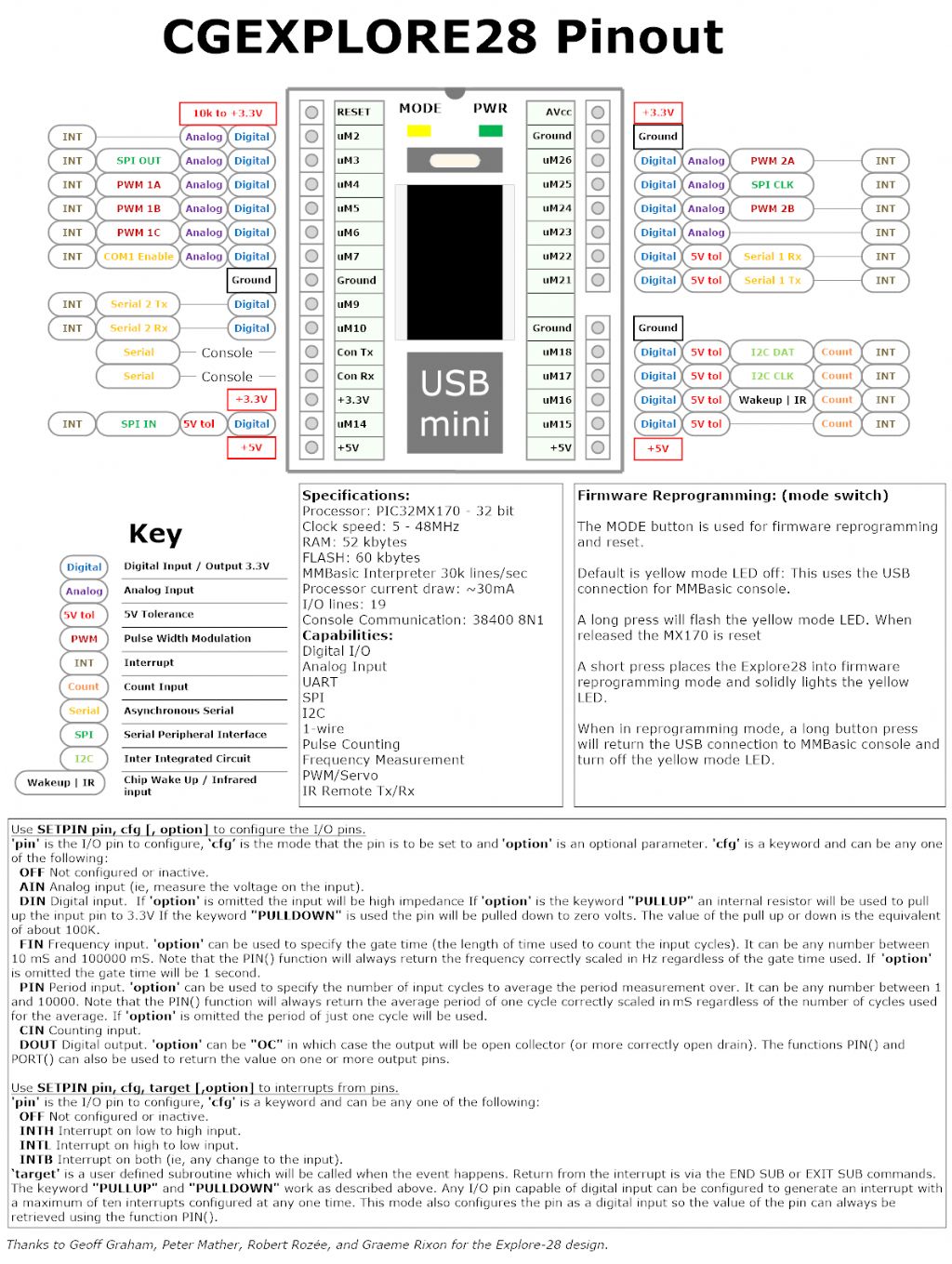

The image and PDF below is a 1-page pinout reference for the Explore-28. If you see anything wrong, please let me know.

Very nice overview sheet
I have not checked it for errors though as I will need a bit of time for that!
Posts: 2991
Posted: 07:32am 02 Jul 2017
Is it not worth labelling Pin 1 as 'Reset' instead of '10K to +3.3V'

I'll be making one for the Ex64, plain 28 pin chip, and others, too.
It is a more colorful version of the info in Geoff's fine manual. It fits a 'style' that seems to be popular wth the Arduino and Raspberry Pi.

  WhiteWizzard said   Is it not worth labelling Pin 1 as 'Reset' instead of '10K to +3.3V'
It is RESET on the inside of the board graphic.

strictly speaking, AVcc should be described as "10ohm to +3.3v".

  robert.rozee said   strictly speaking, AVcc should be described as "10ohm to +3.3v".
rob :-)
Thank you! I'll make that change.
