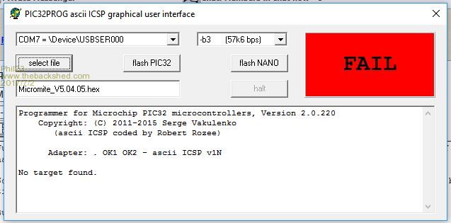

Just attempted to upgrade a few of my devices to 5.04.05 with the Microbridge Y not having any luck.
Sometimes I don't get the LED to light when I press the program button, seems a bit timing based maybe.
But when I do get it to come on the program reports target not found.
First devices I was trying were 28 pin backpacks & when I changes back to the Nano based programmer they both flashed ok.
Any ideas anyone?
Phil.

Posted: 02:16am 02 Jul 2017
No other terminal software connected.
Also no other connection to the backpack other than the M/B.
IE, I don't have a power connection.
Assuming it goes via the 6 ICSP connector like the Nano one does.
The LED goes off immediately after the software identifies the programmer.
On Win10 & tried with the native driver & the one on Microchips site.
(Not expecting that to change the issue).
Noted now also that the mode button appears reliable on USB/2 & maybe not quite as on USB/3 ports.
Phil

Posted: 02:38am 02 Jul 2017
  Geoffg said  You might have a power supply issue.
Power seems to be the issue.
Same failure with an E64 with just the M/B.
But if I power the E64 via a different USB port it flashes fine.
And way faster than the Nano. 2:06 Vs 52 seconds.
Suspect it might be something to do with Toshiba's power management.
Phil

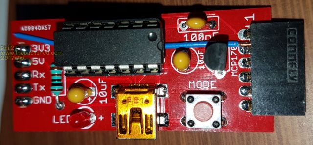

Regarding the standalone MicroBridge (MB) module:
Not sure if anyone else seeing this but if the MB's serial Rx pin is not connected to anything, and the USB is attached to a PC, then the button seems to be very unresponsive (i.e. LED not lighting up)
Sometimes, when bringing my hand near to the MB PCB, it causes the LED to flash at about 3Hz. When (or rather IF) I get the LED to turn on when the button is pressed, then I get inconsistent 'success' with a 'programming session'.
My current solution is to simply short out the Rx & Tx pins and then power up the MB, then the button responds 100% of the time as it should. Also, subsequent 'programming sessions' work without issue.
NOTE: This is with a PIC16F1454. I have not tried with a 1455 yet to see if this is different! Its as if the Rx pin should not be 'floating'. The MMX144, E28, and BackPack v2 (which all incorporate a MB onboard) do not have the above issue because the MB's Rx pin is not floating.
To be clear, the above 'issue' is when using a laptop powered via a PSU (i.e. not on battery). Could be a ground issue - will look into this more.
Be interested if anyone else seeing this issue - and if so, does a jumper link on Rx to Tx 'resolve' the issue?

I make this:
and have not had any issues.
Posted: 08:56am 02 Jul 2017
try adding a 10k pullup to the switch and see if this helps.
rob :-)

Posted: 12:04pm 02 Jul 2017
a 10k resistor soldered between pins 1 and 4 of the 1455.
rob :-)

Posted: 04:19pm 02 Jul 2017
on the E-28 i found it necessary to add the 10k pullup resistor to prevent erratic behaviour similar to that described. if (for whatever reason) the select input is detected by the firmware as being high for more than 2 seconds, the 1455 firmware will exit ascii ICSP mode.
yes, an internal pullup is configured, at the time i double-checked this was the case with peter. but bear in mind that pin 4 has the additional role of Vpp, where it needs to be able to have 13v fed into it to enter hv programming mode, so may by design behave differently to other pins.
rob :-)Edited by robert.rozee 2017-07-04

Posted: 08:24pm 02 Jul 2017
  WhiteWizzard said  My current solution is to simply short out the Rx & Tx pins and then power up the MB, then the button responds 100% of the time as it should. Also, subsequent 'programming sessions' work without issue.
Just tried WW's suggestion, Bridging Tx & Rx pins, & the button responds 100% also; but I still get target not found when connected to a Backpack.
I can get it to flash successfully though if I take a jumper lead from the 3.3V on Con2 to the 3.3V pin on the LCD Backpack.
Will try the 10k pull-up a bit later after work, but it seems that that power is not getting to the ICSP via Con3.
Phil.

Posted: 09:23pm 02 Jul 2017
So after a close look at the diagrams in Silicon Chip, (and reading things...),
I see there is no power to Pin 3 of the ICSP connector; that's what was causing me to get no Target Found.
Must say I overlooked that & presumed power was present, & it behaved like the Arduino Nano programmer & powered the Pic from via the ICSP connector.
Also the photo of it alone plugged in to the backpack above the PicKit3, added to that assumption.
So is it fair enough to hardwire the 3.3V to Pin 2 on the ICSP?
Or is that going to give me other limitations on different devices.
Phil.

Posted: 02:03am 03 Jul 2017
i would suggest connecting a diode (a 1N1418 should be fine) from 3v3 to pin 2 of the ICSP connector. this will mean that if the target device has no power present then approximately 2.7v will be supplied to it, while if already powered the diode will be reverse biased and not conduct.
i would also suggest adding the 10k pullup between pins 1 and 4 of the 1455.
the arduino NANO solution was designed to supply up to 50mA of power to the target device (the same as a pickit2/3 can supply), with this supply turned on and off under the control of pic32prog. this ensured that the target device was powered ONLY while being programmed and verified.
unfortunately this wasn't practical within the design constraints of the 1455 solution - the 1455 had insufficient spare pins to parallel up to create a switchable 50mA supply, and there was a desire to not require an external switching transistor; the main application envisioned at the time was for the 1455 to be on the same PCB as the target device, as is the case with the backpack V2 and the E-28.
rob :-) Edited by robert.rozee 2017-07-04

  robert.rozee said   a 10k resistor soldered between pins 1 and 4 of the 1455.
I was going to report back about an hour ago to say that this fixed things. However, I then built another unit (with the suggested 10K) and I had the LED flashing with an 'approaching hand', and an 'intermittent' button (i.e. would not switch on the LED when button pressed/released).
So went back to test first unit and it now 'mis-behaved'.
The ONLY way I can get the button to respond 'cleanly' is with something connected to the MB's Rx pin (as mentioned before - I short this to Tx most of the time).
This is with a PIC16F1454 - not been able to get hold of DIP 1455's to try and see if these behave differently.
WW
EDIT: I've also built a third unit and same 'erratic' button behaviour with the 10K added.
So something definitely strange with behaviour unless Rx not floating.Edited by WhiteWizzard 2017-07-04
Posted: 06:29am 03 Jul 2017
try moving the 10k pullup to the RxD pin (ie, between pins 1 and 5 of the 1455). what you are describing rings a bell from a case i saw 10 years or so back, a floating RxD pin picking up noise and causing an 'interrupt storm' in a system that would tie up all the CPU resources with servicing those interupts.
when in ascii ICSP mode there is no reason i can think of for the 1455 to need to be servicing serial interrupts - the UART could even be shut down.
please report back your results.
rob :-)
