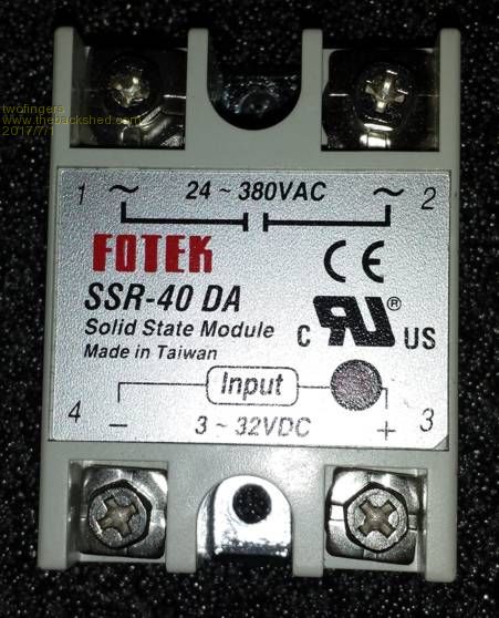

  kiiid said   For control of mains-powered stuff zero-cross synchronisation is needed.
Is it possible with the mite?
How about a cheap SSR (solid state relay)?
MichaelEdited by twofingers 2017-07-02
