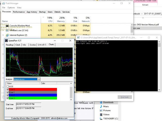

Not a bug,
But it is seeming to hammer my CPU pretty hard.
Laptop seemed rather hot when I picked it up tonight.
Up around the 80° mark.
Closed all the IE sessions & also MMbasic for DOS & the temps fell right down.
Tried 4.5 & temps went up again;
Then 5.4 & same results.
Screen capture shows the reaction.
Not sure if this is an expected anomaly or it using the CPU while idle.
Phil.
Posts: 3368
Posted: 01:56am 02 Jul 2017
All versions of MMBasic poll the console in a loop when sitting at the prompt looking for input. In the DOS box this is in part caused by the limitations of the OS but it is not a great issue because Windows will automatically limit the amount of CPU assigned to the DOS box. Your images show about 13% which is fine.
