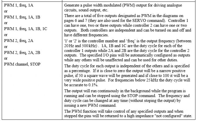

I want to generate a continuous tone for a piezo but when I use
PWM 1,3000,50
the tone is in short bursts, I have altered the duty cycle to no avail.
I remember doing it once before but forgotten how.

OK problem solved. I was using a small amplifier board and the MM signal must have been overloading it causing it to cut in and out.

Well here ya go anyways Edited by hitsware 2017-06-29

Yes, I have finally learnt to read the manual BEFORE I post.
