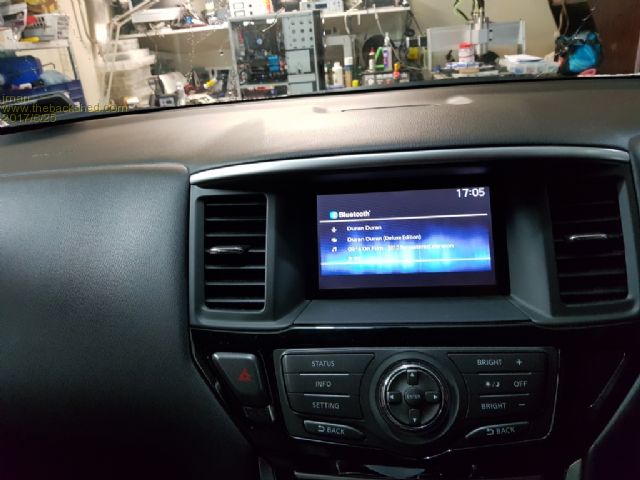

Sharing is caring so I thought I would share my little Project i did with MMbasic and a PiZero.
The idea was to add bluetooth streaming audio to my car. (Has every other feature hands free calling etc..). So the first attempt was an off the shelf Logitech bluetooth reciever pluged into the Aux inputs this worked rather well but the comments from Co workers and my mates were along the lines of (Come on John were's the song info and surely you can do better than that blah blah). So challenge accepted.
Attempt number two was pretty cool Grogster kindly sent me a Paralax serial to video module I interfaced this to a Microchip RN52 Bluetooth module using a Micromite (170) and now I had a rather retro looking display with the song meta displayed on the Orginal car LCD (via the Video in).
Now came the comments about the 8bit colors and retro look

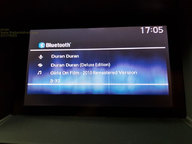

Attempt number three. Pi Zero same Bluetooth module. And a bash script via the "system " command the outcome looks like this
The system works by getting the song Meta data via the serial port then MMbasic writes this to a txt file and a bash script overlays the text onto a jpg(using Imagemagick) that in turn is displayed via the composite port (using FBI)

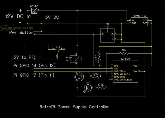

One more piece of hardware was added a startup / shutdown controller for the Pi that detects keyon and off.
I am happy to post the files if anybody is interested

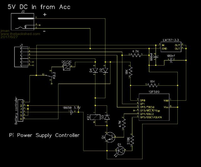

I use a homemade ATX style PSU for normal use and a modified version that has a 18650 cell to supply power when the key is switched off to enable the Pi to shutdown.
I used the 18650 as i did not want to run any extra wires as the system is powered via a lighter socket 5V adapter

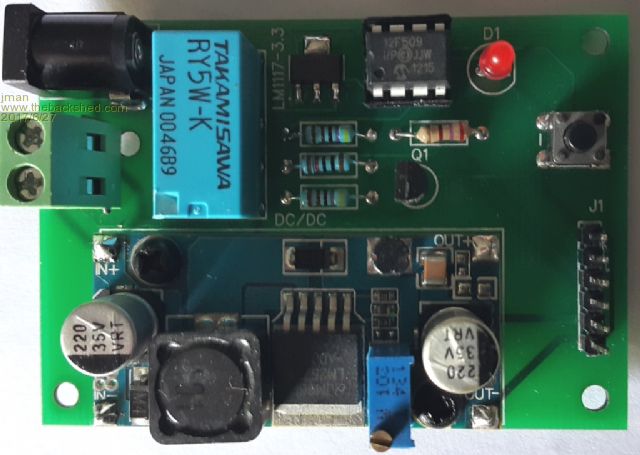

I have a few blank PCB's should anybody want one they are not perfect has i forgot to add a 100uf cap across the pic 12f509 but the do work quite well.
Modified version for use in the car (hope it's correct draw after the fact :) )
