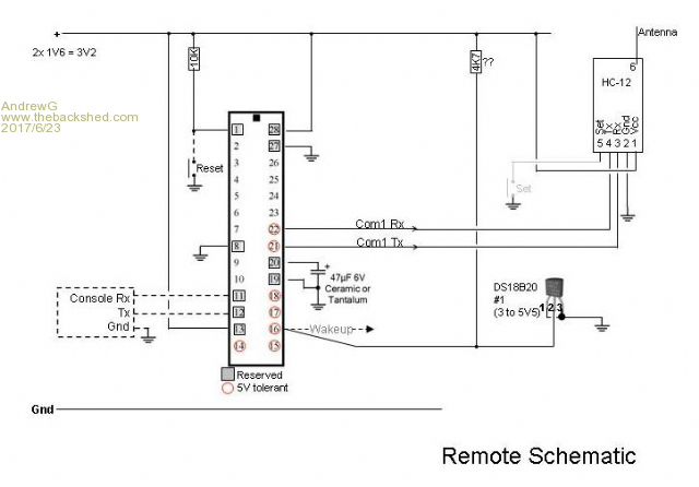

Hi,
I am trying to power a remote temperature sensor with two AA cells but appear to be only getting less than two day's life out of the batteries.
1) Is my circuit OK?
2) Would 3x AAAs be better?
The batteries are powering a MM (28 pin), an HC-12 and a DS18B20.
The remote code is below. It sends a simple NMEA sentence (with checksum) twice, then sleeps for 59 seconds. If the temperature is unchanged it goes straight back to sleep, otherwise it sends the new temperature (twice) then goes to sleep.
I can:
a) extend the sleep time (10 minutes is better but I wanted to see more readings whilst developing the code)
b) reduce the CPU speed
c) send the sentence only once and discard any erroneous transmission receipts
d) turn the power down on the HC-12 (a marginal(?) improvement at the risk of reducing range within the house)
3) which of these are likely to give most bang for the buck?
4) Is there anything else I can try and any improvements to the code??

Posted: 04:37pm 22 Jun 2017
Have you set the HC-12 into low power mode.
I haven't done any tests but the datasheet has idle current of 16mA in the default mode compared with 80uA in FU2 mode
Using 3 AA cells will put the voltage higher than the micromite can handle.
2 cells has the voltage good for the micromite but marginal for the HC-12 as the voltage drops off.
Posts: 10110
Posted: 09:26pm 22 Jun 2017
Completely agree with Jim here. You need to connect the HC-12's 'SET' line to one of the MM I/O lines and use that to put the module to sleep. This is a LITTLE more tricky then most other modules that just use an EN(able) line to control the module.
In the HC-12, you have to:
1) Put the module into SETUP mode by pulling the 'SET' line low
2) Issue the command AT+SLEEP via the serial port
3) Return the 'SET' line high again
Current consumption of a sleeping HC-12 is about 22uA so says the datasheet.
To wake up a sleeping module, you have to pulse the 'SET' line low again(50mS should do it), then return the line high again and WAIT 200mS for the module to reset itself.
I plan to do some testing on this concept shortly, so I will be able to confirm this soon, as I have not actually ever slept an HC-12 module, but reading the datasheet, the above would appear to be the sequence.
Edited by Grogster 2017-06-24

(I assume my circuit is OK except that I should connect all unused pins on the MM to Ground?)
Cheers,
Andrew
Posts: 10110
Posted: 06:24pm 23 Jun 2017
I used to think that you should ground unused pins too, but I seem to recall someone saying that this was only a requirement for CMOS logic gates on discrete logic chips, so that a floating gate input does not cause the logic to do odd things.
With microcontrollers, I don't think you need to worry, and I have not bothered to connect unused pins to anything since I started using microcontrollers. I think it was the PICAXE forums who taught me that particular bit of knowledge.
IE: If your code never references the unused pins in any way, they will remain as high-impedance inputs(as set from power-up), and will have no effect. Even if they DO float up and down, the code won't care, as it totally ignores them if you never reference them anywhere.
That is my understanding, anyway. I am sure other members more in the know then me will correct that if I am in fact wrong, but I hope not!

Hi all,
I have been distracted over the last two months but I am still trying to minimise consumption on my remote temperature-sensing MM. I believe I have included all of your suggestions in the code below (if not pl. let me know) but I still have a sleep current of 0.5mA - much better than before but is it the best I can achieve?.
Is the DS18B20 causing this?
The circuit is the same as above except that pin 5 of the HC-12 now goes to pin 14 of the MM.
Thanks again,
Andrew

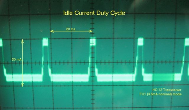

Time to measure the current through each the several branches of your simple circuit to get to the bottom of where that .5 mA is going to! I would start by measuring the HC-12 and the MX170.
According to the relevant data sheet information, you're still high by a few hundred microamps. (8 bit processors will go several orders magnitude lower than the MX170 in sleep current.)
When using sleep mode, in general lowering the clock speed of the uP does not give any advantage in long term average current use, since the uP when awake takes longer to accomplish its tasks while in run mode. The sleep mode current is fixed -- not affected by the run speed.
Incidentally, the minimum voltage for the DS18B20 in parasitic mode is 3 volts, whereas in direct power mode it's 2 volts. I'd recommend the direct power mode connection anyway.

  TassyJim said   compared with 80uA in FU2 mode
Seriously- someone actually named it the FU2 mode???

I've powered the DS18B directly and now have a test going to see how long the batteries will last. I'm also fiddling with the base station to make proper use of the data.
I'll report back from time to time.

Golly, both lower idle mode currents are achieved by using the full 16mA current duty-cycled!
I discovered this trying to get a good measurement of the sleep current. So far the
sleep current doesn't seem to be much different than the lowest 80 uA idle current that is provided in FU2 mode.
This scope image shows the FU1, 3.6 mA average mode. The vertical scale is labelled in milliamps. The trace fuzz is due to noise pickup, not anything from the device under test.
