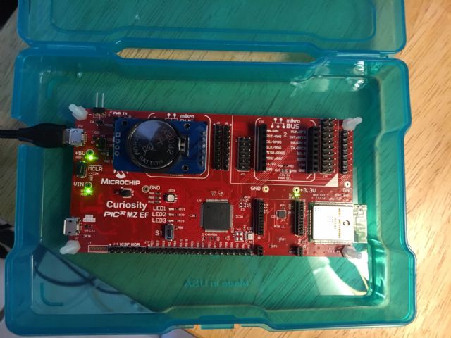

Posted: 08:43am 09 Jul 2017
I have added a DS3231 RTC to the first mikro-BUS (J5) of this board. It can be initialized with OPTION RTC 67, 66.
Here's a picture of the RTC on the Curiosity Board.
