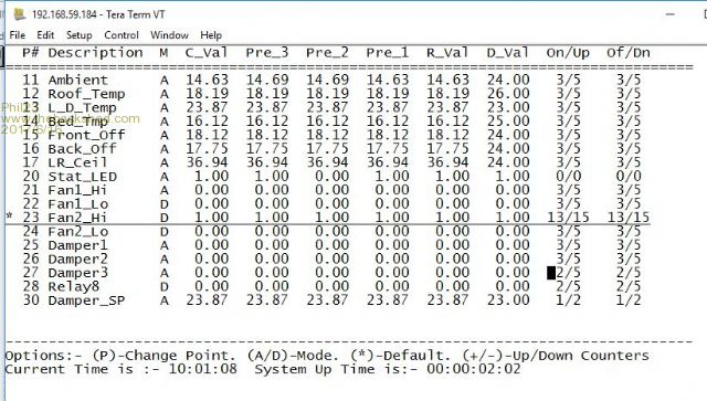

Hi All,
Can anyone see what I'm doing wrong here?
On the output screen, the "Active Point" is marked with a "*" at the beginning of the line.
It's hard to follow that line easily with the eyes, so I thought I'd simply underline it.
I can get that working, but then the formatting changes; Stuff moves to the left...
Esc[4m attribute set to underline the active point, & stuff is moved left.
This is the code that's writing the screen.
The line to set the underlined attribute is shown commented out.
After the point number & description are printed he TAB(18) is supposed to move to column 18 before the C_Val is printed.
That seems to be what fails when the attribute is set.

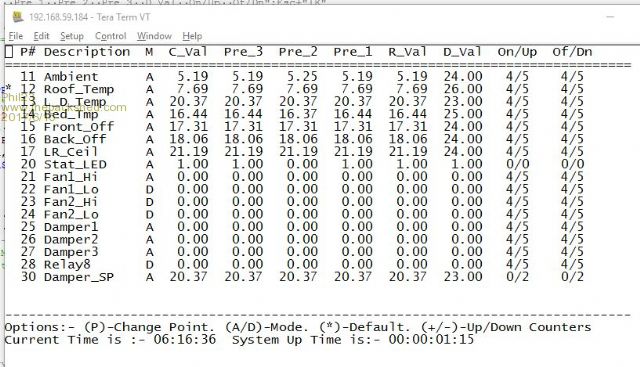

I think it's something to do with the TAB().
If I try padding it out with spaces, I end up with a mess, Double spaced etc,
And I lose the alignment of the /'s separating the On/Up & Of/Dn values if they contain 2 digit values.
Works fine until I try to introduce the attribute to underline the current point.

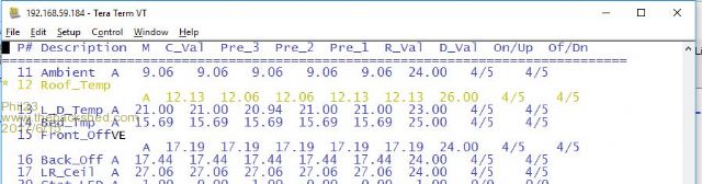

  WhiteWizzard said  Out of interest, does the weird formatting issue still occur IF instead you use a colour code setting to change the colour of the 'highlighted' line (instead of setting it with an underline escape code)?
That was my first idea, to use colours, but it had similar issues, and was also breaking lines in two.
Not sure what you are referring to as colour codes;
I just tried colours with VT attributes.
IE
[Code]
Yellow - Esc[33m
Blue - Esc[34m
and for the underline I used
Underline - Esc[4m
Normal - Esc[0m
[/code]
Using the colours I get this.

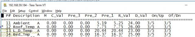

Pretty much the same in PuTTY.
Need to look at the HEX output, as I think the TAB is causing the issues.
It's almost as if the characters used in the Esc codes are adding to the cursor position counter when MMBasic tries to output the spaces.

I can see there the TAB() gives me grief, & usually my screen layouts are controlled by the space characters.
In this one, keeping all the forward slashes in a vertical line is required for the layout to appear correct.
Doing that with spacing became messy & long winded, while the Tab worked just fine until Introduced some control sequences.
Phil.

Posted: 12:58pm 18 Jun 2017
  Phil23 said
Puttting TAB() aside because it wasn't working properly, was tainted by one thing...
Why???
Phil.
In MMBasic, TAB(x) inserts extra space characters into the PRINT stream to increase the size of the stream to the number in the TAB command.
MMBasic has no idea where the data is going to or if the receiver interprets any characters as other than printing characters.
TAB() is just one of the ways you can format your data before sending it.
MMBasic seems to ignore some control codes when counting character positions.
Sending a TAB character CHR$(9) requires the receiving device to do the formatting. In the case of a VT100 terminal, the tab stops can be set at any position so you would normally send the commands to clear all currently set positions and then set the required positions before using CHR$(9). If you rely on the tab stops being set before you send your data, you may be in for a few surprises.
The other way control print locations is to use the VT100 commands to locate the cursor. Rob's at$() functions makes this easier to do. You need to set the line as well as column each time. This can add more work in keeping track of the line position but gives the most control.
Earlier versions of MMBasic used the PRINT @x,y command to print at specified locations on the screen. It was intended for use on graphic screens but would also send the VT100 positioning commands (suitably scaled) to the console.
