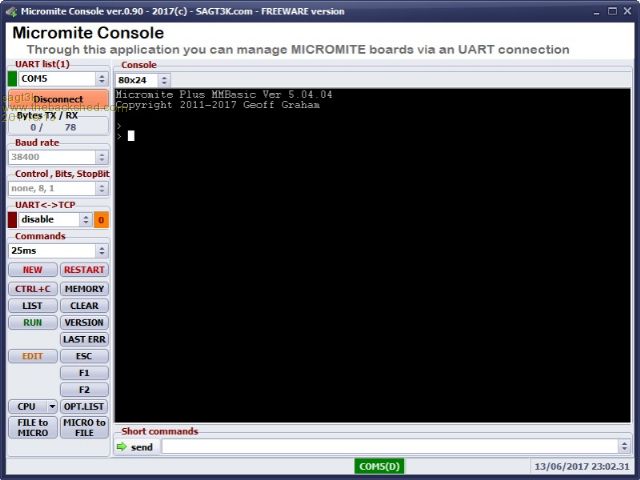

I'm developing a series of applications with a new platform and wanted to share this first application with you, "Micromite Cons", which is totally FREE, portable and optimized for all Windows O.S. XP/7/10 32&64bit.
Is a simple console that allows you to connect to any COMx port that is connected to a board with Micromite board.
The features:
- Console is optimized for micromite tech
- different shortcuts to optimize some frequent steps
- UART over TCP capability
- Xmodem protocol for data transfer Micromite>PC, PC>Micromite
- Ability to modify the rows in real time
As I said, I'm using a new development tool and if you can kindly test it

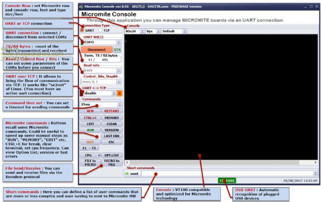

Hi to Everybody
A small summary of the "Micromite Cons" features:

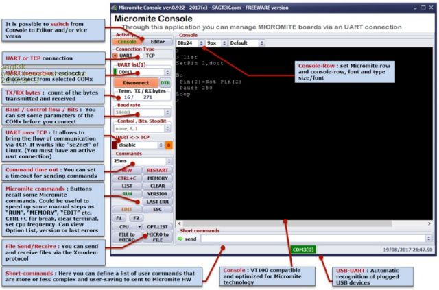

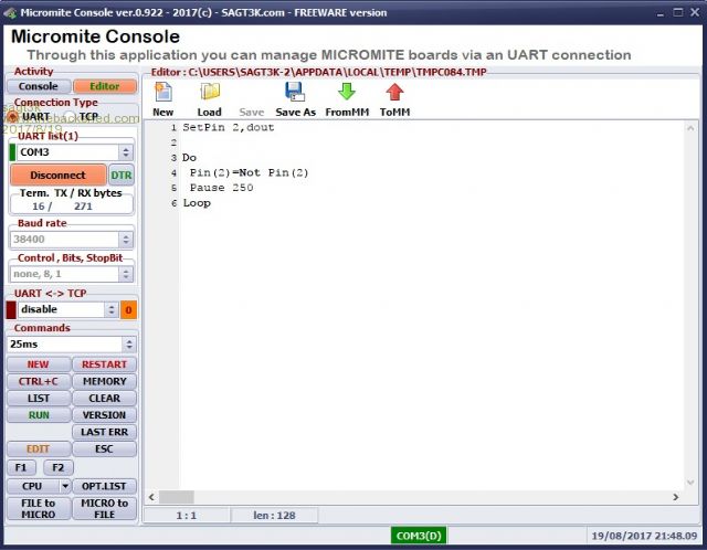

Hi to Everybody
A small summary of "Micromite Console Beta v.0.922", here some features:
+ VT100 terminal on UART or TCP connection
+ Autodetect USB/UART
+ TCP server, serial on TCP service with :port (as SER2NET)
+ Send/Receive data with Xmodem protocol
+ Drag & Drop file .bas from Win/Explorer to Console (direct file transfer)
+ Start implementing of an editor with several features (from ver. 0.922)
+ Drag & Drop file .bas from Win/Explorer to Editor (load file on Editor)
+ Send/Receive data with Xmodem protocol to/from Editor
- Saving settings (To be implemented)
- Editor, search, and replacement functionality (To be implemented)
here you can find link download
Thanks for your suggestions.

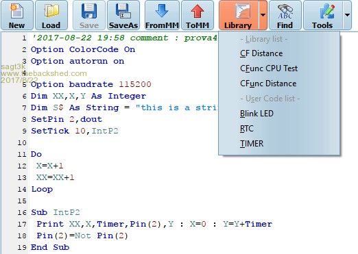

New features have been implemented in the editor on ver.0.924:
+ When start application 2 directory are created \Library and \UserCode. Here you can copy .bas files to make them available to the popup menu "Library". When selected the file will be inserted in text editor.
+ Text proposal when digit a part of text or press CTRL+SPACE
+ Standard popupmenu on press right mouse button
+ Implemented "Tool" button. A few features implemented including a comment entry and the "goto line".
- It still remains to complete all the MMbasic instructions with CTRL+SPACE
- It still remains to complete save of settings
Here the link to
download v.0.924
