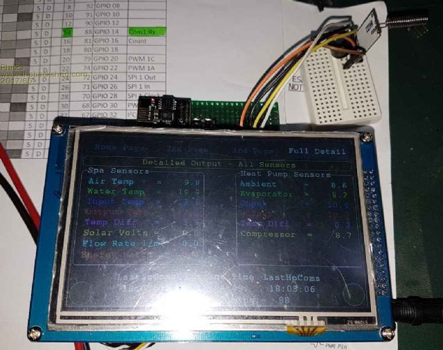

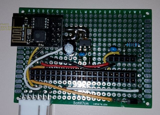

Anyone tell me where I'm going wrong here?
All my MM's have ESP-01's & HC-12's.
Wifi on the console, 433mHz on Com1.
All working OK & even the dodged up breadboard experiments were fine,
but the one pictured below is giving me grief.
Wifi is fine on it. but the HC-12's not receiving.
If I remove the Wifi module it receives....
Voltages are fine. 3.33 & 5.02, & the ESP has it's own AMS1117-3.3.
0.1µF on input & output & also a 100µF on the 3.3V out.
The HC-12 just gets it's power from the E100, but has 0.1µF across Gnd & Vcc.

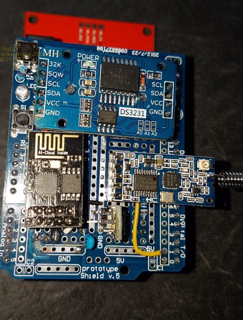

The similar thing I made for the CGMicro 64+ works fine, & I don't think it's the 2 transmitters being close, as I tried the moving the HC-12 to flyleads & still the same.
My other E100 has both modules on a Proto board making a 3 layer sandwich & it's fine...
Have checked both E100's, swapped ESP-01's & HC-12's around & all modules work fine elsewhere. Even tried jumping a 1000µF electro across the HC-12, no change.
Got to be something dodgy with my power...
Any suggestions?
Phil.

I'm actually totally tearing my hair out;
But....
Maybe the Set line is floating & going low!
Good thought.
The other one is on the E100 Proto Board you did with me.
(One we missed the dimensions on.....).
It uses the same pin outs, is minus the 1k & diode, (WIP),
but works just fine on both E100's.
Yes, both modules are on separate ports;
The ESP-01 is on the console, via the plug at the bottom left.
The HC-12 is on Com1; pins 24 & 88; & must be the right way around cause it receives data is I remove the ESP-01.
If I pull the ESP out while powered, it starts receiving coms,
AND if I plug it back in, it keeps receiving coms UNTIL the Wifi establishes a connection.
I've got my coms packets flying about every 1 second (140 byte packets),
I'm running it really excessively ATM just for the sake of testing & trying to break things & deal with collisions etc.
Might go & try Welding the Set pin high; that could be an issue.
And as far as the one on the Arduino Shield goes, it works fine on both CGM's.
Phil.

Tried this;
which is way better separation than the other E100 OR the Arduino shield, but still no fix.
I have 5 other HC-12'ss chatting, it's just this one that won't, and the common denominator when I swap stuff about is that board I built....
Only other thing that comes to mind is the ESP's proximity to the Display/E100.
But at any rate the ESP works fine; I can get to the console;
Load code with no retries in the Xmodem, all that part is fine.

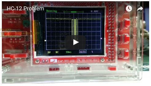

Still tearing hair out here on this; ignored it until 5 minutes ago.
Just put the Wiz BangGood DSO138 scope the TX pin of the HC-12.
Can see the pin sitting at 5v & spiking low when data is received with the ESP unplugged.
Plug it in & IF the ESP connects to the AP, it drops to 3v & stops swinging all the way low.
Only dips down about 0.25 V from it's high state.
IF I unplug the cable in the bottom left of the first photo (6 Pin), the Coms signal out of the HC-12 returns to normal.
That plug just has the 3 wires for the console connection to the ESP-01, it plugs onto Con6 of the E100, just using 3 of the 6 pins, Gnd, Tx & Rx.
Can't see how that could possibly be holding the HC-12's Tx high.
It's all wired fine. no 3.3v goes near the HC-12 & I've lifted the diode that clamps it, even shorted the 1k series resistor in the Tx line.
Just cant find a wiring fault.....
The console connection works fine regardless of what the HC-12 is doing....

Could it be something dodgy with the way I've setup the AMS1117 to power the ESP-01?
I've got a 0.1µF on In & Out to Gnd & 100µF electro across the output.
Pretty obvious what's going on now, just don't understand why?

Phil23
Joined: 27/03/2016
Posts: 1667
Posted: 09:24pm 07 Jun 2017
It's actually connecting the Rx line (Pin89) of the console,
that Pulls the Tx line of the HC-12 low;
the Rx Pin for Com1 (Pin 88).
It's got to be something to do with me running the ESP on it's own 3.3 reg & the HC-12 on the E100's 5V rail.
Does any of this make sense?
And like I mentioned above this 2nd E100 is fine if connected to the other proto board that's usually on the other E100.
Phil.

Problem solved now!
Short between pins 88 & 89 on the 2nd E100.
Bit of a scratch about between them with a pin & it's now working fine.
