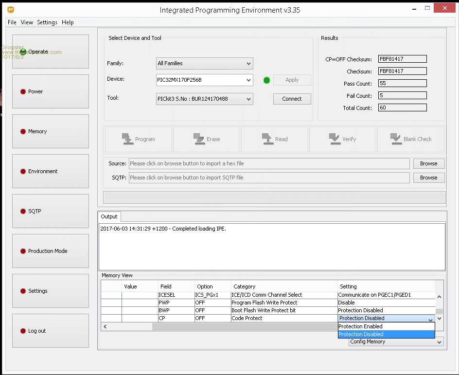

I have found how to change that in IPE v3.35, which is what I currently have on my computer:
Got this from the IPE manual.
1) Click VIEW, tick SHOW MEMORY.
2) In the memory view window that appears down the bottom, click the drop-down button.
3) Select CONFIG MEMORY
4) Right down the very bottom is the CODE PROTECT bit setting.
5) Click 'Protection Disabled' on the right column.
6) Change this to 'Protection Enabled'
I have yet to actually test this out, but this would seem to be where you find that setting anyway.
I should be able to READ the 170 for the current running code etc, then change this bit and write it back to the chip, and save a local copy of that HEX for duplication purposes. I need to try this out though.
With this bit set, and in MMBASIC turn off the console, and disable the break key, it should be reasonably well protected against your average joe trying to read it.
This also has the effect of locking me out of my own code too, but that is why you would keep TWO versions of the same code: one that was a fully editable backup version, and one production version which is locked down.
