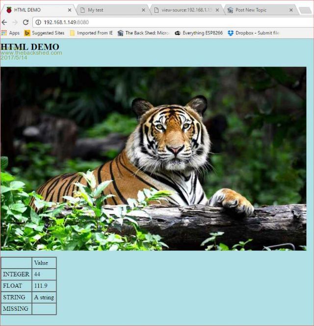

This now includes the full capability to program fairly sophisticated webserver applications with stylesheets, embedded pictures, and favicons entirely in MMBasic
HTML pages can be written and stored as files. These can have MMBasic variable names included within the file in {} brackets and then these will be filled in from the current values in the MMBasic program when the page is requested.
To explain this an example is probably best. Here is the simple HTML file used to create the image above.

In it there are four MMBasic variables referenced: tcurrent, tmax(2), tmin, and fred
In my test program (full version below) these are defined as follows:
Option explicit
Option default none
Dim integer tcurrent=44
Dim float tmax(3)=(19.6, 22.4, 111.9,88.6)
Dim string tmin="A string"
Note that "fred" is not defined and I am using option explicit
to display the page from MMBasic we simply use
TRANSMIT PAGE "filename"
The MMBasic software will automatically create a correct HTTP 1.1 header and fill in the page with the current values of the variables. Missing variables will be ignored. Formatting of numeric variables is exactly the same as would be done by a PRINT statement. As usual STR$ can be used for more specific formatting.

Posted: 11:16am 14 May 2017
  matherp said  Let me know if it works
That page works for me. When I "view source", this is what I see.

and the HTML including the variable substitution strings
<html>
<head>
<title>Remote Thermostat</title>
</head>
<body>
<form name='f1' method='get' action='index'>
<h2 align='left'>Remote Thermostat V4.0</h2>
Update Code: <input type='text' name='Security' size='6' value='000000'>
<br>
<p>
<TABLE BORDER='1' CELLSPACING='0' CELLPADDING='5'>
<TR>
<TD>Heating</TD>
<TD BGCOLOR='{HCOL}'>{heating}</TD>
</TR>
</TABLE>
</p>
<p>
<TR>
<TD></TD>
<TD>Temperature</TD>
</TR>
<TR>
<TD>Current</TD>
<TD>{TCURRENT}°C</TD>
</TR>
<TR>
<TD>Max</TD>
<TD>{TMAX}°C</TD>
</TR>
<TR>
<TD>Min</TD>
<TD>{TMIN}°C</TD>
</TR>
</TABLE>
</p>
<input name='Check' type='checkbox' value='Reset' onClick='this.form.submit()'>
Reset Max/Min<p>
<TR>
<TD>Thermostat</TD>
<TD><input name='R' type='radio' {CP(0)} value='A' onClick='this.form.submit()'> Off<br></TD>
<TD><input name='R' type='radio' {CP(1)} value='B' onClick='this.form.submit()'> {SP(1)}°C<br></TD>
<TD><input name='R' type='radio' {CP(2)} value='C' onClick='this.form.submit()'> {SP(2)}°C<br></TD>
<TD><input name='R' type='radio' {CP(3)} value='D' onClick='this.form.submit()'> {SP(3)}°C<br></TD>
<TD><input name='R' type='radio' {CP(4)} value='E' onClick='this.form.submit()'> {SP(4)}°C<br></TD>
<TD><input name='R' type='radio' {CP(5)} value='F' onClick='this.form.submit()'> {SP(5)}°C<br></TD>
<TD><input name='R' type='radio' {CP(6)} value='G' onClick='this.form.submit()'> {SP(6)}°C<br></TD>
<TD><input name='R' type='radio' {CP(7)} value='H' onClick='this.form.submit()'> {SP(7)}°C<br></TD>
<TD><input name='R' type='radio' {CP(8)} value='I' onClick='this.form.submit()'> {SP(8)}°C<br></TD>
<TD><input name='R' type='radio' {CP(9)} value='J' onClick='this.form.submit()'> {SP(9)}°C<br></TD>
<TD><input name='R' type='radio' {CP(10)} value='K' onClick='this.form.submit()'> {SP(10)}°C<br></TD>
<TD><input name='R' type='radio' {CP(11)} value='L' onClick='this.form.submit()'> On<br></TD>
</TR>
</TABLE>
</p>
</form>
</body>
</html>

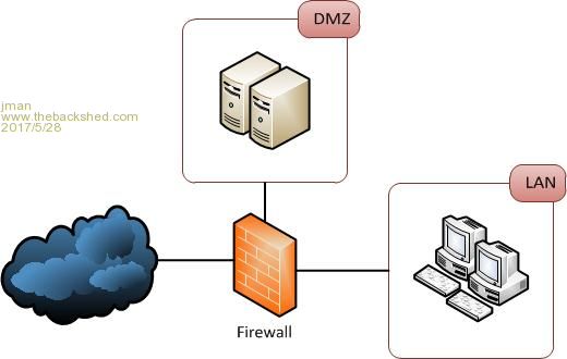

People across the planet - please help me test something!
I am trying to do something based on Peter's demo Thermostat. To ensure I have things set-up correctly can anyone out there with a couple of spare minutes log onto the following URL:
whitewizzard.ddns.net:1234
Hopefully you will see the familiar Thermostat webpage. If so, can you then simply click between 27'C and ON (no need to enter an Update code - just click/toggle between 27'c and ON)
WW
OA47
Joined: 11/04/2012
Posts: 1065
Posted: 11:43am 27 May 2017
WW tried to logon using Msoft Edge on W10 but timed out.
Graeme
Posts: 2998
Posted: 11:46am 27 May 2017
Thanks OA47
Please, if you have time, can you try my WAN IP instead as follows:
151.228.246.21:1234
Thanks . . .
OA47
Joined: 11/04/2012
Posts: 1065
Posted: 11:51am 27 May 2017
ww, I can ping the address ok but still no response from browser.
Graeme
Posts: 2998
Posted: 12:00pm 27 May 2017
I just done the 'traditional' switch-it-off-and-back-on-again trick!
Getting a faster response now here - any different there now?
EDIT: Do you have port blocking on your router? Port 1234 will need to be 'open'Edited by WhiteWizzard 2017-05-28
Posts: 2998
Posted: 12:10pm 27 May 2017
Someone is out there I can see you!
