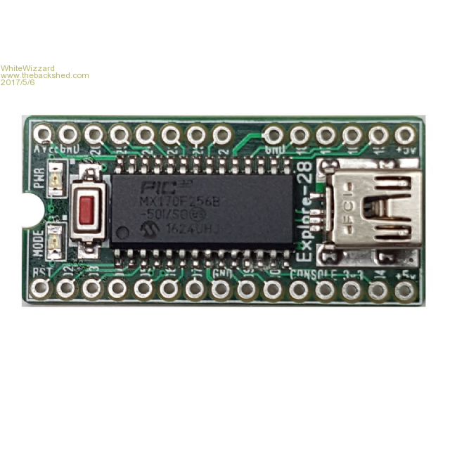

Yes, there is a new version that uses the SOIC 170 chip instead of the QFN, making assembly much easier. Exactly the same size as the QFN version. Tidyed up component placement on the bottom layer. Still has the 1455 USB chip on the bottom layer, also still SOIC.
Me or Rob will start a new thread soon - we are still building the prototypes.
Edited by Grogster 2017-05-06

I have built a couple of the new E28s, and they are currently under stress testing here.
Confirming that, as expected, this module is so much easier to assemble than the QFN version.
They layout was 'fine tuned' over many emails and I think that Grogs has done a great job on the PCB to fit Rob's circuit within the size it is.
Will be adding the SOIC Explore28 onto micromite.org very soon (for people this side of the planet wanting to get their hands on one)
WWEdited by WhiteWizzard 2017-05-07
