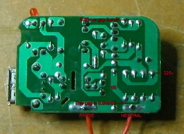

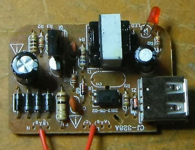

Found another one.
0.5mm between the Phase and Neutral on the PCB, 0.25mm between the rectified AC at about 325v DC, and another part of the circuit - lovely.
These were sent to me as part of a product I bought from China, that used USB to charge the battery, so these are little 5v USB charger adaptor things, but I thought I would look inside to see what it was like.
This kind of design is not exactly unheard of, unfortunately.
They have used an opto for feedback, and there are some anti-creepage slots around there, but nothing at all around the incoming mains and in the area of the rectified DC once past the full-wave bridge. I would certainly not design the mains side of things to allow the phase and neutral to be THIS close to each other, to say nothing at all of the 300v potential on the other side of the bridge with it's 0.25mm clearance - yuk!
I have binned all of these. You can charge up the thing on USB power anyway, so you don't really NEED the plug-pack charger, if you have a spare USB port.

Look on the bright side, it would be impressive to watch (from a distance) when the ergatrons finally jumped the gap......
...... Don't worry mate, it'll be GoodToGo!
Posted: 03:10am 29 Apr 2017
an easy 'fix' would be to lift the ends of the two diodes and 1r resistor and join them together (with a thin piece of fuse wire) floating in the air. that would remove the most serious failings.
with zero cost, the original designer could have corrected the clearance issues, and implemented a fuse with a fine PCB trace.

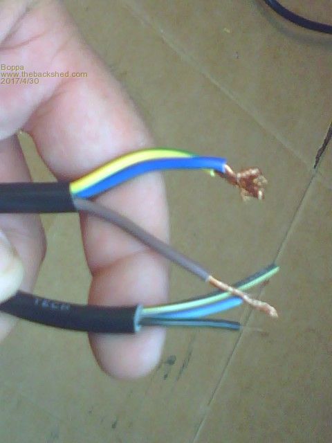

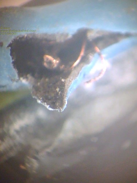

Another one to watch out for (I'll see if I can find the pics, not sure which computer they are on) was of a 10A marked computer IEC powercord (my old work literally had hundreds thrown in boxes out the back) which we used to replace a damaged kettle power cord- it lasted a couple of days before tripping out the main shed breaker
On inspection, it had a hole about 5mm long literally blown in the side of the cable about halfway along
Closer inspection showed why, despite being marked at both ends as 10A, on cutting it open and comparing against a `proper' 10A cord, it was visibly thinner on the outside, and the inner conductors on the dodgy cord were the same size for the copper and insulation combined as just the copper alone on the proper 10A cord
Plugged into a 2400w fast boil kettle it was bound to fail, the copper area was tiny
And the only exterior visible sign was it was a bit thinner than the real 10A cord, the extra insulation disguised mostly the fact that the wires inside were tiny, and of course it had moulded plugs both end so you couldnt see it- even the colours were incorrect

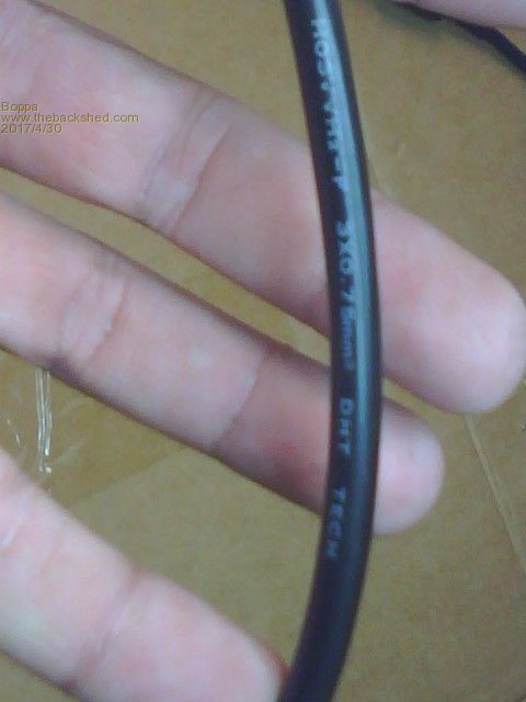

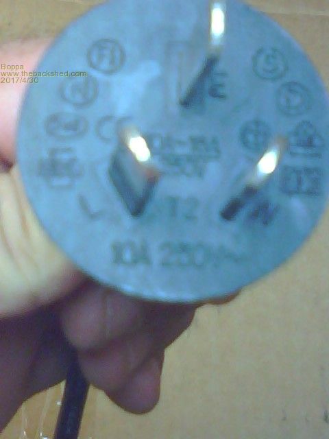

Found the pics of dodgy IEC power cords
Note both ends were marked as 10A
Cable markings
note size and incorrect colours
Hole in cable after it fused

I've got to admit, I always find the analysis of what went wrong after an event interesting. More so in the interest of what learnings can be taken out of it, or in the case of electronics, mechanical items, etc, what modifications/improvements can be made to prevent future issues.
Must be the jet engineer in me.......
In the case of Boppa's laptop power supply, the pin breaking away is interesting. Overheating? Poor moulding? Either way, shouldn't happen.
And the cord, I wonder if they forgot the decimal point in the middle of '10'?

The cabling, thats purely criminal, intended to deceive that its adequate for the job when its woefully underspecced (presumably to save money by using a cheaper wire/ less copper

No, these were plug-packs supplied with pagers. The pagers themselves can charge up the battery via USB or just use a standard AA cell - or these charger things. The reason for the USB connection, is that the same socket on the pager is used to program it for the frequency and RIC code you need etc. That is pretty standard really - everything these days charges from USB power.
I never even plugged these units in. I just cracked one open for a look. I would NEVER use the 230v plug-pack thing supplied from anything you buy in China. If I had to, I would replace the plug-pack with one from Jaycar, which would be certified and tested for electrical compliance you see. If I supplied that as part of a thing, and it set-fire to someone's property, my company would be in REALLY hot water, so it is pretty much my policy to never supply the factory-issue plug-packs from China if they come with one - not worth the risk. Just so everyone knows.
I note also that the "Regulator" in these for the 5v side of things, is just a zener diode across the output - pretty crude. I have seen catastrophic things happen to equipment powered from a zener "Regulator" when it fails.....
Zener's for a voltage reference, fine. Even for a few mA, but as for using them as a charging voltage regulator needing to supply a few hundred mA or an amp or more - nasty.
